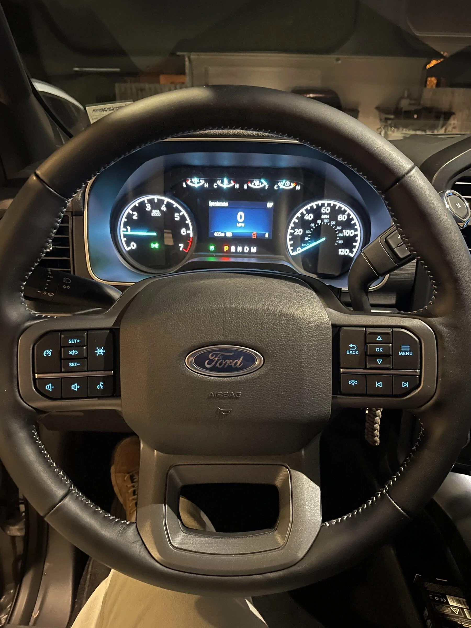

Ford F-150 Leather Steering Wheel Swap 9C5362D4-4461-4C71-8F5D-4628DAEC136D
Ford F-150 Leather Steering Wheel Swap AB81A161-588F-4EC3-B115-1ED0B8FF6B31
its not bad

So I purchased mine from Cmo_5.0 on Instagram and it was direct swap but you can’t swap over your buttons it’s easy

ML3Z-3600-JA
I've seen for about 321.00 new

Same inner parts. So swaps over

I did the swap on a 2020 F15 without any problems or complications. I purchased my New take off leather steering wheel off of Ebay for 300 bucks.Air bag was no problem disconnect negative battery cable and wait about 15 minutes to remove it. The wiring inside of the Steering wheel was a plug and play. The only difference I can forsee is if the replacement sterring wheel has the HEATED option. The sterring wheel will work ,the plug in may be different. In that case you can reuse the switches off of your existing steering wheel. I say GO FOR IT! Looks so much better

$175+tax new in Canada. Just bought one yesterday using my Ford pass points, plan to install on my 300a on Saturday.
ML3Z-3600-JA for 175 please let us know where. I thinking of doing the swap

What does powering down the srs system consist of doing? Just disconnecting the battery?
yes, disconnect battery for about 15 minutes.
