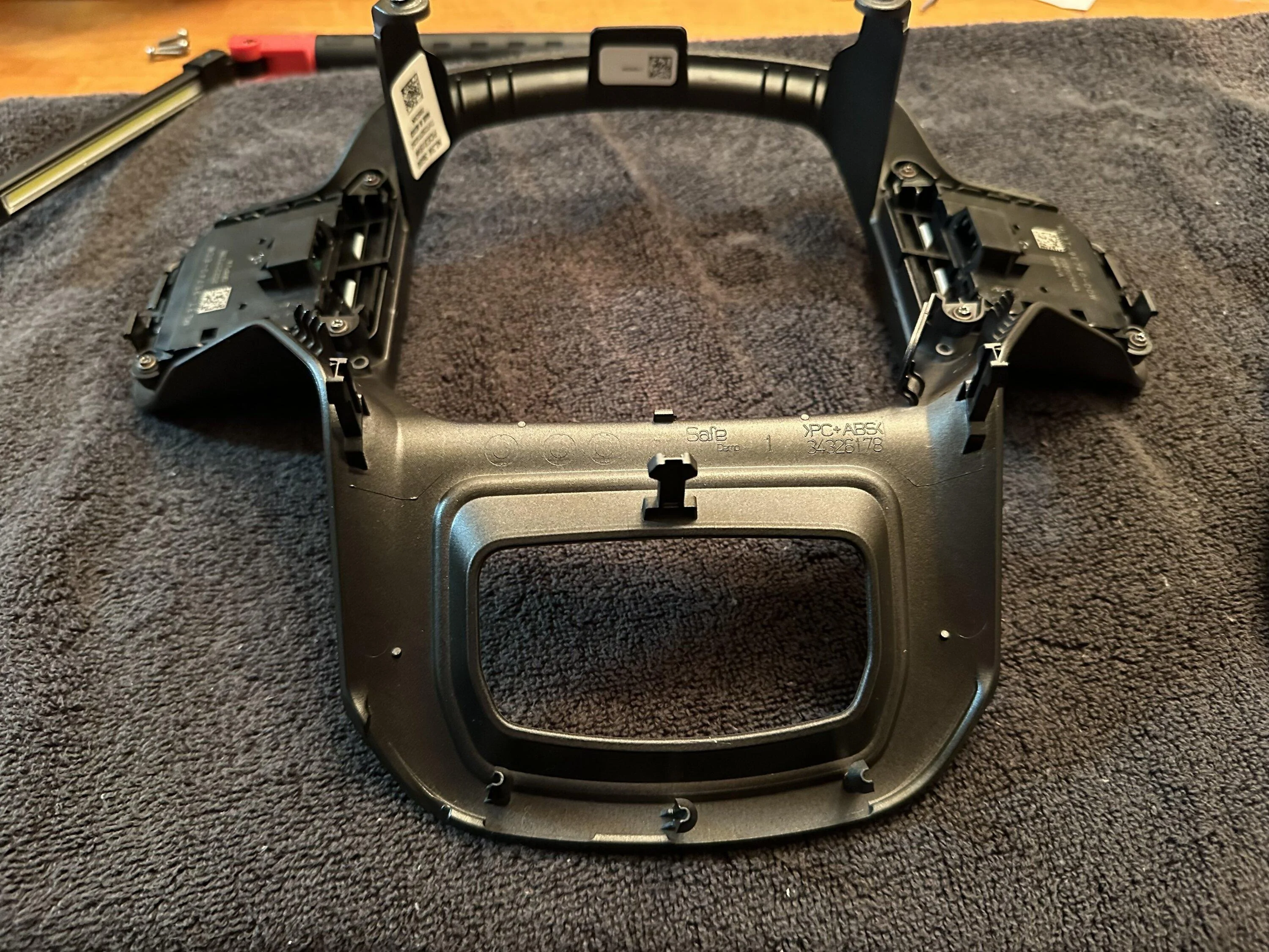

Top picture is the Platinum trim. Notice the two pieces plastic welded together. This requires a recess in the Platinum steering wheel. Also notice the holding tabs. Platinum has 2 non-round prongs at the bottom.
Ford F-150 Steering Wheel Trim Swap 9E3C8770-B4D4-4698-8952-5C71885AF094
This is the Raptor trim. Notice the single trim piece and the 3 round prongs at the bottom.
Ford F-150 Steering Wheel Trim Swap 37444EDB-A8CD-4BE1-91F1-30E60F714E54
