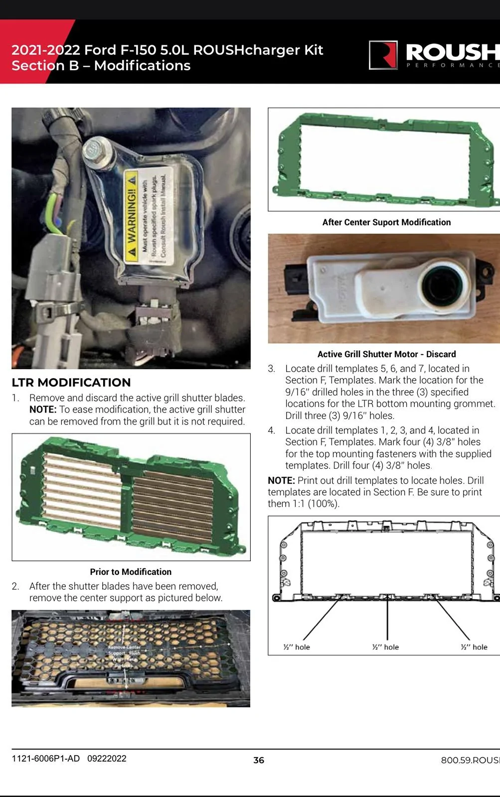

On order ‘22 RCSB.
The temperature here in Texas has started to climb (80* today). I'm wondering if it's a good (or bad) idea to remove the active shutter system in front of the LTR? I imagine the same question applies to either a supercharger or turbo setup.
Thoughts?
Roush instructions say to remove the shutter blades.
Ford F-150 Keep or remove the active shutters? IMG_3314
Interesting…. Thanks, I can understand their purpose but I would think boosted applications need all the air flow they can get. I did check in with Whipple but no response….. I’ve watched my IAT (unsure how accurate it is or where the value comes from) fluctuate quite a bit. The difference between actual air temperature and IAT is usually around 15 to 20 degrees. I've seen it as high as 35 degrees difference at slower speeds. When I check the shutters at those times they look like they’re 50% open. I bet those times when the difference is less the shutters are open…..
