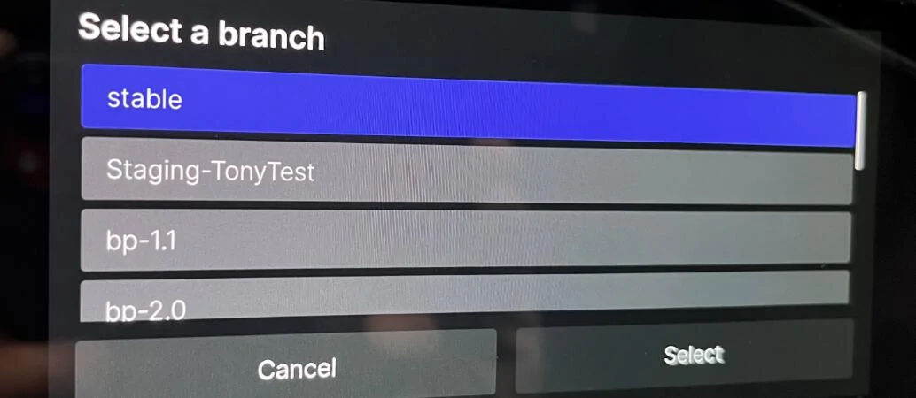

My C3X had the Connect to internet... message earlier this month. So I had to turn around to go back and connect to my home network. Got it cleared so I could go on my trip.

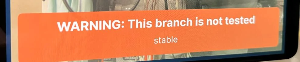

Also seeing:
Ford F-150 Introducing Bluepilot! A Ford specific fork for Comma3X / OpenPilot 1750174495437-3m

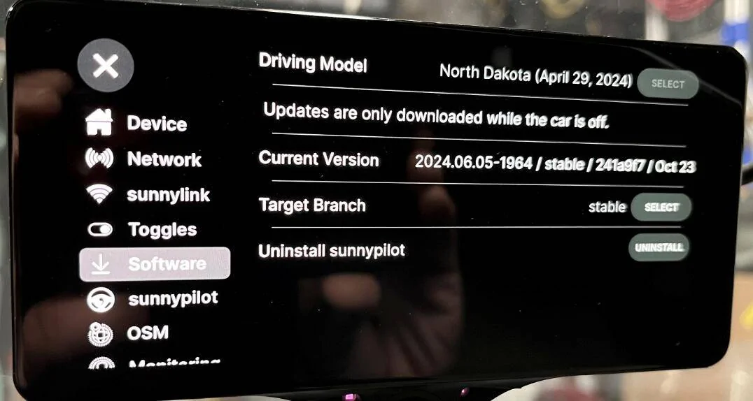

I'm running this when I did my C3X install Dec 2024
Ford F-150 Introducing Bluepilot! A Ford specific fork for Comma3X / OpenPilot 1750174537595-8y
Is the stable I'm using equivalent to bp-1.1?
Ford F-150 Introducing Bluepilot! A Ford specific fork for Comma3X / OpenPilot 1750174607283-6d
Will picking a different branch stop the Connect to internet... message?
Ford F-150 Introducing Bluepilot! A Ford specific fork for Comma3X / OpenPilot 1750174686231-s9

These "connect-to-the-internet" messages are an unintended consequence of renaming all the branches. There is no exact equivalent of stable anymore, but moving to 3.1 and turning off advanced lateral control should result in pretty much the same driving experience. You would want to set the PC blend high and low ratios to 0.4 to match stable.
The warning that branches aren't testing is normal, Comma puts that on anything that isn't their main branch.
