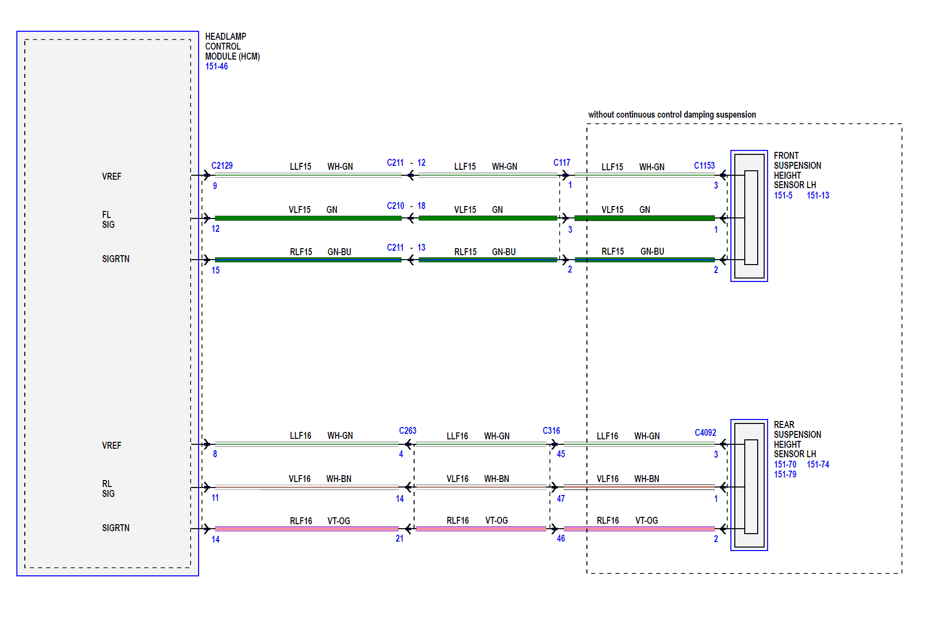

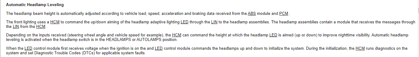

I am adding the LHS ride height sensors to my 501A with projector headlamp swap to get the auto-level. Does this mean that my ride height sensors will not work unless I calibrate them with FDRS? I am not adding a VDM, I am wiring the ride height sensors directly to the HCM as is done with all 502A trucks without CCD/scales
I think no, only because there are no "calibration values" in the HCM as-built like you see in the VDM. I do not know for sure though.

In the F150 non-ccd or scales, there are only two height sensors. One front and one rear both on the drivers side. They send a analog signal to the HCM for leveling. No VDM.
CCD or Scales get 4 sensors (the sensors are different for CCD vs non-CCD) they feed into the VDM, they are calibrated in the VDM, and for leveling the HCM gets the "height" info over the CAN bus from the VDM.

I certainly hope that’s the case. In the little bit of Jessie’s brain I’ve been able to pick, he’s never mentioned having to calibrate the sensors, and he’s usually pretty thorough, so (here comes another educated assumption) I don’t believe there’s calibration needed SPECIFICALLY for the auto level from the ride height sensors. After all, it *should* be able to auto level based off of positional difference between the two height sensors.
From my perspective its a sound assumption. The headlamp assemblies can be manually leveled, so if done in a relatively level truck condition, the HCM then simply looks at the difference in analog output front to rear and adjusts accordingly. Auto leveling seems like a relatively unsophisticated calculation compared to scales or the next level up CCD. In those cases fronts to rear and side to side become a factor.
