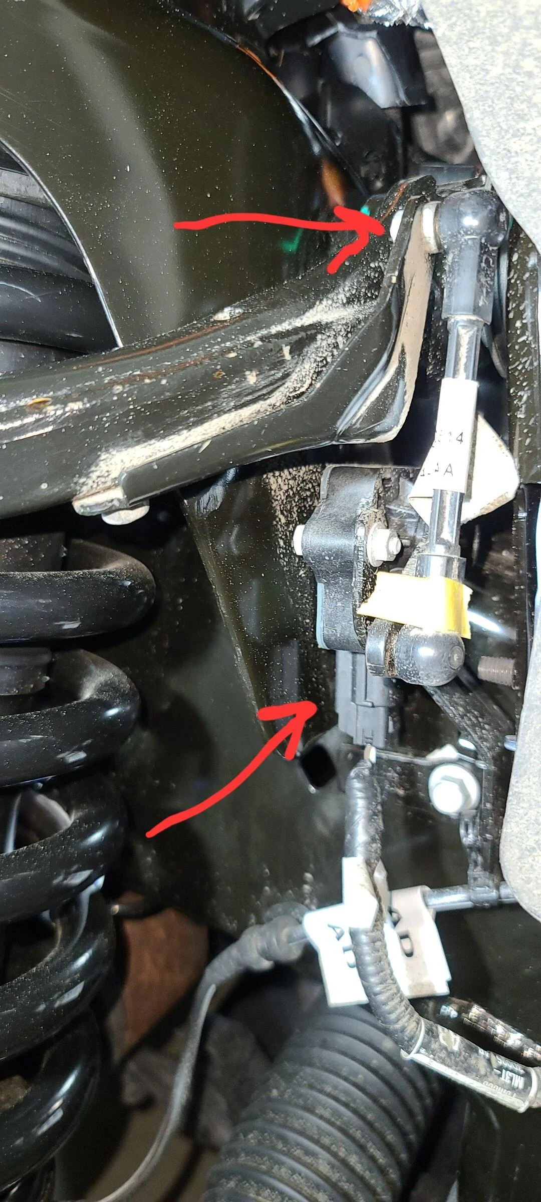

At the front you similarly have wiring going into the bottom of the strut for CCD, but I assume the auto-leverler device on each side serves dual purpose for headlights and scales?
Ford F-150 Installing Onboard Scale? 20220430_105919
Ford F-150 Installing Onboard Scale? 20220430_175923

Unfortunately the news is not great. I reviewed the wiring diagrams in preparation for ordering a VDM and trying to add this to my truck. The auto leveling sensors we all have on the LH side of the truck are indeed used for onboard scales as well. There is a slightly different wiring harness that routes their signal to the VDM instead of the HCM for the head lights as it currently is. Now the the really unfortunate part is that the scales system uses two more of those same sensors installed on the RH side of the truck. We lack those completely, but it appears at least portions of the wiring exist.
So I would say it is technically possible to add scales, the scope of work makes it more than it’s worth for me. At a minimum we need: VDM, 2 additional height sensors, some wiring harnesses or custom wiring, and a boat load of programming.
The height sensors get calibrated using FDRS so it might be possible to address suspension changes by recalibrating after changing a suspension part.
