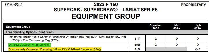

I just checked, and yes, CCD requires scales. Which supports the theory that the active damper settings are being driven by data from the 4 corner leveling sensors.
The MY21 Job 2 (when CCD was added) Order Guide shows that scales and CCD are not mutually required for Lariat trim (requires 502A to get CCD, though). For KR and Plat, they are mutually required (Ltd has both standard).

For MY22, order guide is similar, only difference is that scales on a Lariat don't require max towing vs the MY21 requiring max towing, which lends credence to the idea that adding scale functionality would only be a forscan change to enable if you have MY21 CCD Lariat without max towing.
