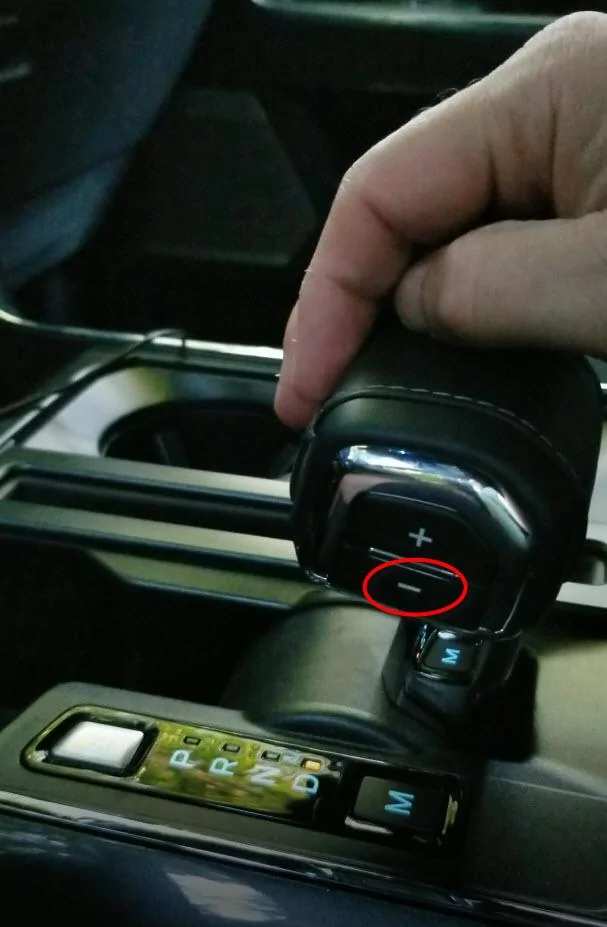

One thing though since I’m not familiar with this transmission, how do you lockout the gears and then unlock them when driving uphill ?
Hi John, if you have the console shifter, hit the (-)button as many times as needed to drop the top gear from 10 down to 7 or 8. When you hit the top of the hill and the load drops off, you can hit the (+) button to put your top gear back up to 10. If you have the console shifter, there is are similar buttons. The dash display tells you what gear you're in, as well as the max "top" gear. Really slick and works great.

Thanks for the explanation and pic. Yes, I have the console shifter that drops inside the console. I knew it was a 10 speed but just not how to drop down through the gears. The pic and explanation answered the mail perfectly. My main goal is to make sure I seat the rings properly to get maximum performance from the engine over time. From my understanding I need drive in Sport mode initially and to keep the RPM up and keep a load on the engine through acceleration and deceleration for the first 20-50 miles. After that I can drop to normal mode and if I encounter hills drop the gear to keep the RPM’s up until over the top and then go back to normal. Once home, change the oil immediately. Thanks again to everyone who provided input to help make sure I don’t screw up my new truck and give it the best chance to last a long time. I can’t wait to get the call so I can fly up and pick it up.
