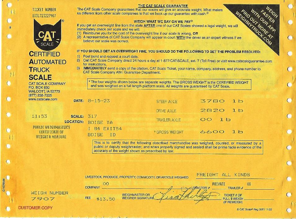

It will definitely be a challenge. The wife and I went to a CAT Scale location with an empty truck and full tank of gas just to see where we are at since we do have some add-ons not accounted for in the original curb weight. The scale showed 6600 even. So......and feel free to check my math:
6600 - 350 for passengers = 6250. This would be my new approximate curb weight.
Using the Ford Towing Calculator for my VIN, the GVWR is 7,350 - Max Payload of 1,288 = 6062 lbs. original curb weight. So I picked up and additional 188 lbs. Let's call it 200 lbs.
After accusing the wife of being the sole reason for the payload increase :censored: , we determined that it was the Ford safe, the spray-in bed liner, automatic bed cover, and protective film package for the front and sides that would account for the difference.
My new Max Payload is now approx 1,100 lbs.

Remaining Payload = GVWR(7350)-current weight(6600)
Remaining Payload = 750
Appears you/wife were in the truck when weighed. Ok
Sticker payload 1288-350(people)-188(add on’s)= 750
You have 750 for hitch, tongue weight and gear in truck.
Since I only have minimal cargo room, it all comes down to tongue weight. The 23' Airstream Flying Cloud specifies a 500 lbs tongue weight, (GVWR is 6,000) but the experienced folks here say I should calculate between 10-13%. With a really good WDS and packing the trailer smart and light, is this still do-able?
Thanks in advance.
I went through something very similar a number of years ago, with similar results. One thing that I've learned over the years is that those CAT scales are tuned to weigh trucks that are 30+ tons, so the accuracy at the lower end is not always as precise as we would like. Further, the scales are rounded to the nearest 20 pounds at each measuring point, which can compound the error further.
Bottom line is that you can take those CAT scale weights with a grain of salt. If you're in the right ballpark, I would assume that it's close enough. Take the yellow sticker value, subtract the known (and reasonably estimated) weights of the passengers and add-ons, and use that value. The CAT scale should be reasonably close to that, but they can be off by 100+ lbs or more. That's "good enough" when weighing the big rigs, but causes us all kinds of heartburn.
I would assume that your actual tongue weight will be probably 800lbs (13% of 6000). Keep as much gear as you can in the trailer and you'll likely be close, but should probably be fine from a payload perspective, assuming that it's just you and your wife in the cab. I wouldn't add many more options, though. :)
