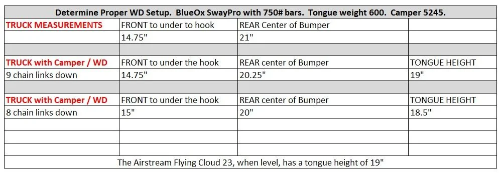

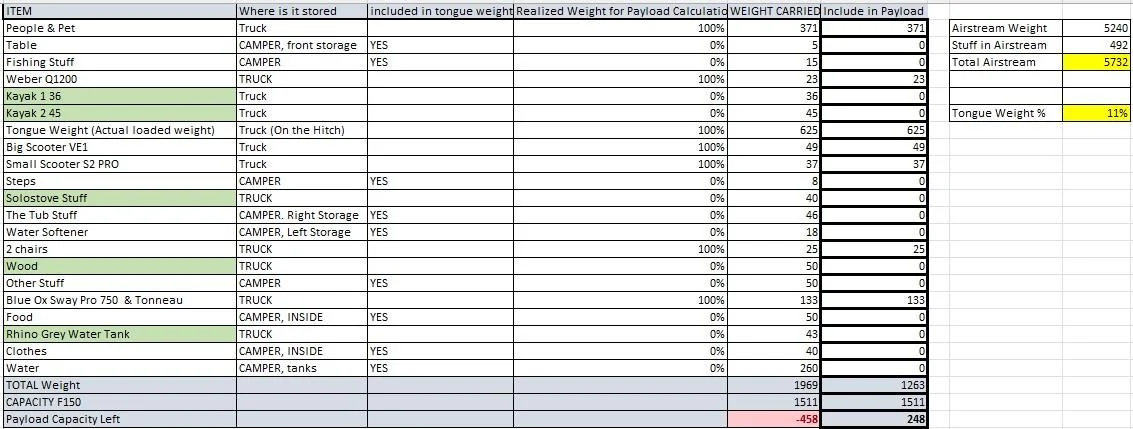

You're very welcome. How about THIS data? This demonstrates how OCD I am...
Ford F-150 I could use some advice from towing experts. Camper Weight Info
Ford F-150 I could use some advice from towing experts. WD Information
Oh, hell yes! Is that first one an auto-formulated Excel spreadsheet?
Of course it is. ;) All I do is enter the weight of the item and the percentage (100% means in truck, 0% means in camper). With this, I can see all the weight I'm carrying, the payload on the truck, and the payload in the camper. The only weight in the camper that matters to the truck is the tongue weight - which is 100%. I've even factored in the gator tonneau cover, the bed rug, and the weight distribution hitch. The combo of that truck that cargo, and that airstream yields 16.2mpg on a round trip from Ohio to Georgia and back. The truck computer says 17.1mpg, but my calculations show 16.2. With that said, I was only getting about 12-13mpg pulling a much shorter and lighter camper ('21 NuCamp Tab400 Boondock), and the airstream tows sooooo smoothly.
