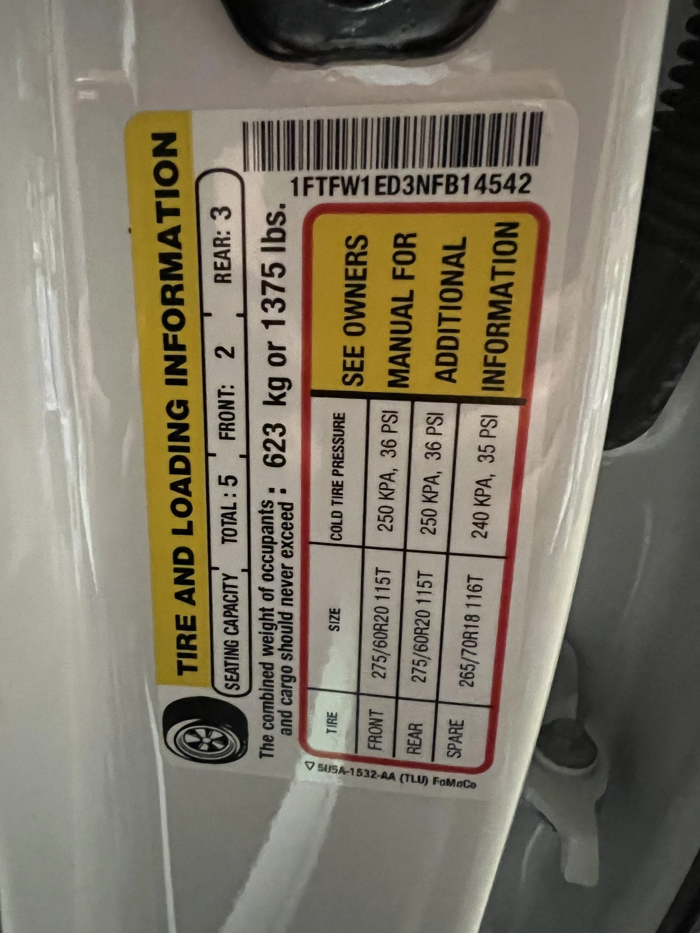

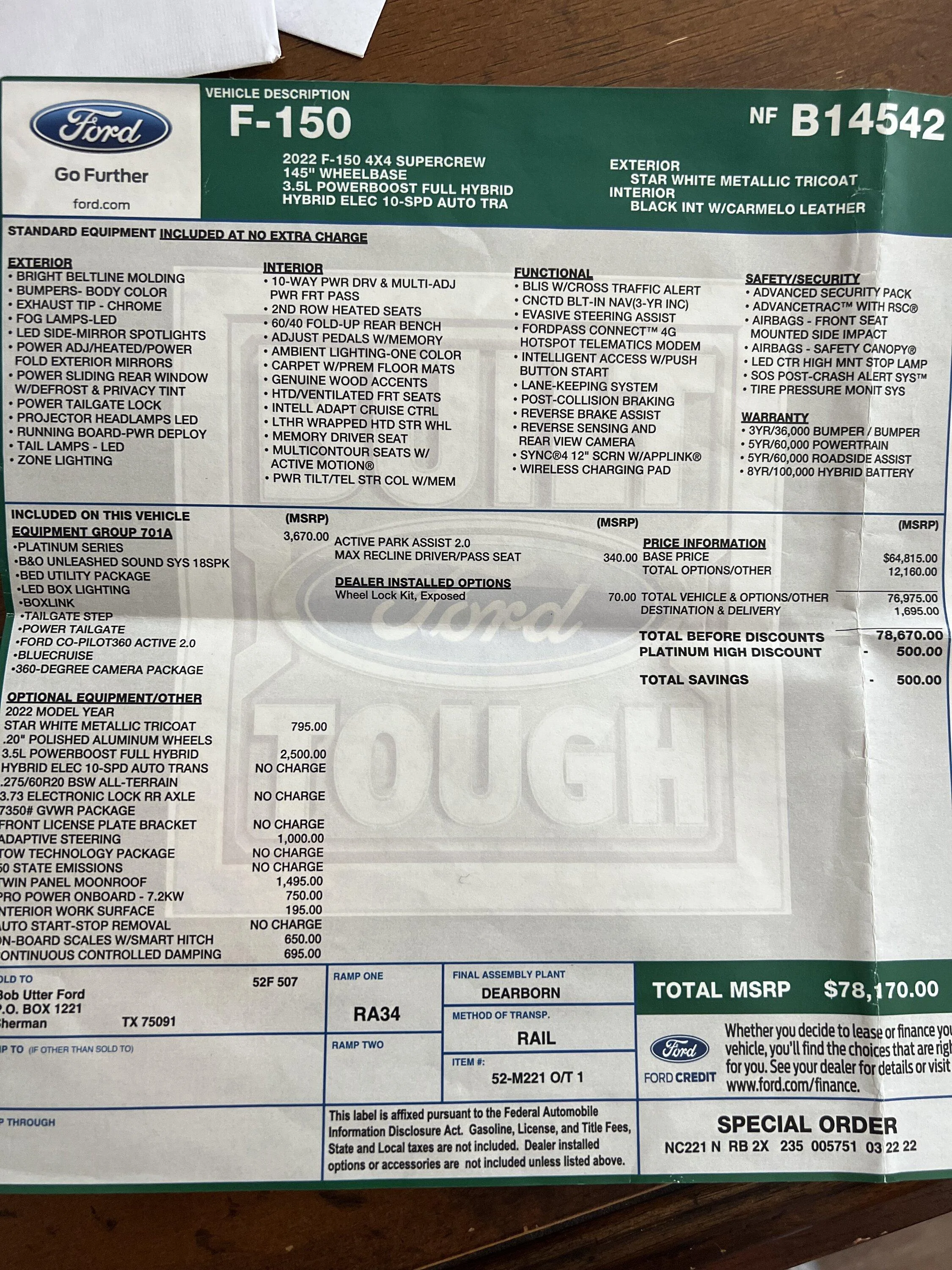

Three things to consider….can you, would you and should you? I have a fully loaded 2022 Platinum Powerboost minus Max Tow and BAP. Since I have CCD/Scales, FX4 wasn’t an option. Best I could find out about Max Tow when ordering and after calling 3 dealerships who didn’t know squat, the only thing I could find that Max Tow offered was an upgraded hitch. The powerboost already came with everything else. Even if Max Tow offered more, I doubt I’d ever need it. Being fully loaded my payload is 1,375 lbs which is more than enough to tow all my toys. Short distances, I don’t mind exceeding the limit a bit. Even if I could tow a 9000lb camper, I wouldn’t. To get most places I prefer to go means I have to drive through west Texas (I live in DFW) and the cross winds are brutal. Towing a heavy wind sail is not something I’d feel comfortable doing in a 1/2 ton truck of any make. Fortunately, I have a motorhome to tow the toys when traveling far. If you’ve never experienced the west Texas/panhandle winds, they blow semi’s and 5th wheels towed by 1 ton duellies over with ease. I’ve seen it many times on trips to Colorado.
oh 1 more thing, if memory serves right, dealers were adding “Tow Package” to all their trucks. I think it was $1,150 option that literally gave you nothing you didn’t already have on the Platinum Powerboost.

So a Powerboost has a Max Tow rear axle even if you don't have Max Tow package?
Man I have seen a lot of conflicting information regarding that infamous 3/4" floating axle and the Powerboost.

So we have Apples to Apples an exact same truck, except you have a shorter wheelbase and no 'stated' Max Tow package.
I do have Max Tow and a longer wheelbase and I have a lower limit than you? Literally makes no sense. "Yah canI go ahead and get the Max Tow Package so I can put less in my truck? Thanks."
Almost seems like some of these are dart board results....
Kinda was my point but I wasn’t very clear. Just like you said, increase tow #s yet reduce payload. On all the higher trim trucks we are limited by payload. It makes no sense to me why its even offered on higher trim trucks. It appears to me the net gain is actually a loss.
