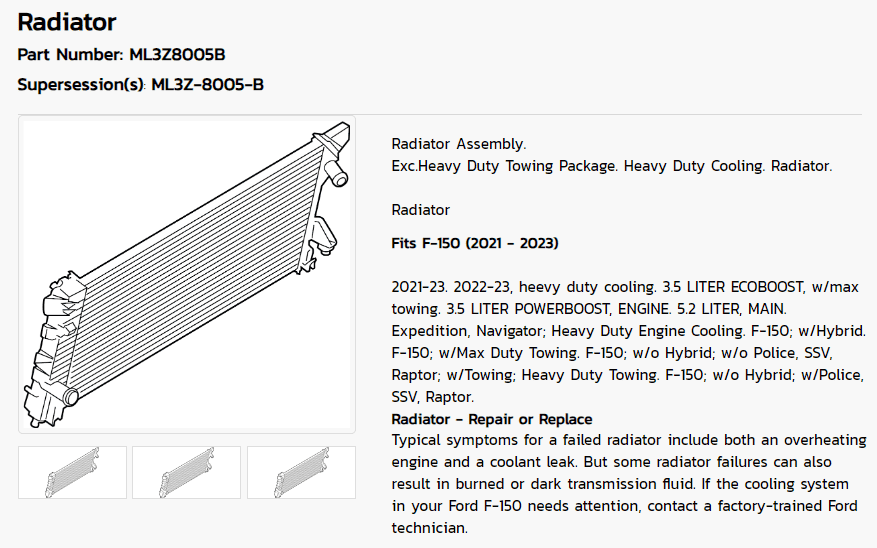

And they say it’s not compatible with a PB? What an elegant solution it might be though. We just need a little more cooling capacity on the margin for heavy power train load situations, and increasing the coolant volume along with air/water heat transfer surface area without any additional modifications could do the job.

2 quarts isn't going to do much on a 210lb transmission. The trans is flanked by exhaust which is radiating heat. I would expect at best marginal results. Nothing is going to beat a front mount air/oil radiator.
As for the mishimoto main rad fitting, not sure why it wouldn't. There's nothing special about the PB's setup. Pull up its radiator part number and see what it says it fits.
The 'big' rad fits just about everything
Ford F-150 How to improve PB cooling??? 1697043632511

So the larger radiator is still solution number one.
