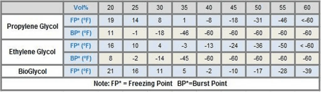

You want to know freeze point and burst point. They are quite different. You also do not dare play such game wo a good refractometer. A bulb hydrometer just isn't accurate enough.
Here:
Ford F-150 How to improve PB cooling??? 1695270355183
"Freeze" point is when it start to slush up. It cannot hurt anything until BP.
40% EG is -13F slush. -60 burst. I would not want to be starting something slushed up though. No idea what i might do to an impeller blade or... I run my performance toys (kept in a garage at night) at 35% and they haven't ever seen a -3f start.
This is getting pretty aggressive, but water is a way better coolant than Ethylene Glycol is, so as much as we can get in helps. Heck, drop down to a properly measured 45% if you'd feel safer.
37% (as I recall) is commonly sold in some warmer parts of the world. Au. as an example.
Here:
