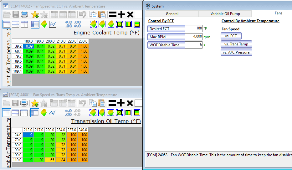

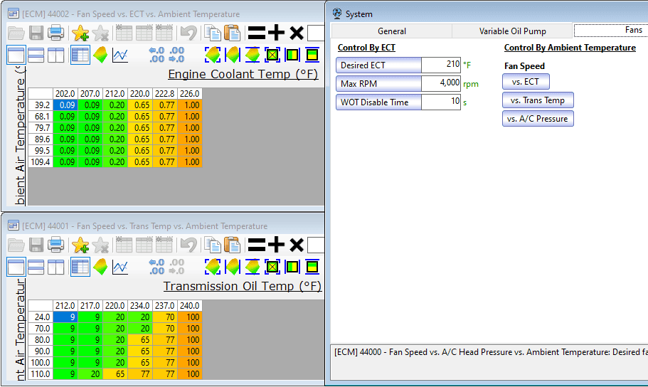

Something else that may be of interest to some people is how our fans are commanded to run from the factory. On my 2021 3.5EB, the desired coolant temp is 210°F and the fans aren't commanded to run at 100% until my ECT hits 226°F or my TFT hits 240°. Even with an ECT of 212°F or a TFT of 220°F my fans were only commanded to run at 20%.
Stock Fan Settings for factory 195°F thermostat:
Modified Fan Settings for my 180°F thermostat:

But they are worse slightly at 230/240 or am I reading it wrong?
For the TFT table, I raised the fan speed from 70/77% to 100% at 237°F and I slightly increased the fan speeds at 234°F. I didn't make any adjustments at 220°F and below.
The ECT table was rescaled so the starting and ending temps are not the same. The factory ECT table had my fan running at 65% at 220°F, I have it set to run at 84% at the same temp. At 202°F, the factory ECT table is set to 9% fan speed, I have mine set to 9% at 180°F and it's up to 32% by 200°F.

Today wasn't the best day for testing as it was only 55°F, but after a quick drive to get things warmed up, I did several back to back WOT pulls to see how high my coolant temps would get and there was a noticeable difference. In my short test today I couldn't get my cylinder head temp over 211°F, compared to easily hitting 230°F after a single WOT pull with the stock tune and thermostat, I'm very happy with this improvement.
