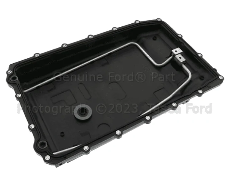

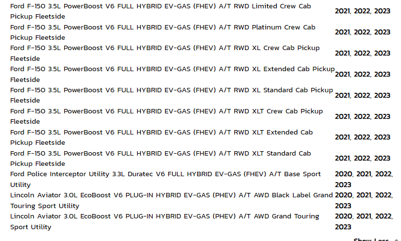

I wish! It's a unique 10R80-MHT. Just different enough that it's a unique pan. Trying to find a high capacity pan is all.
L1MZ7A194A
Ford F-150 High Capacity Transmission Pan 1711663303571-ut
Ford F-150 High Capacity Transmission Pan 1711663342810-ml

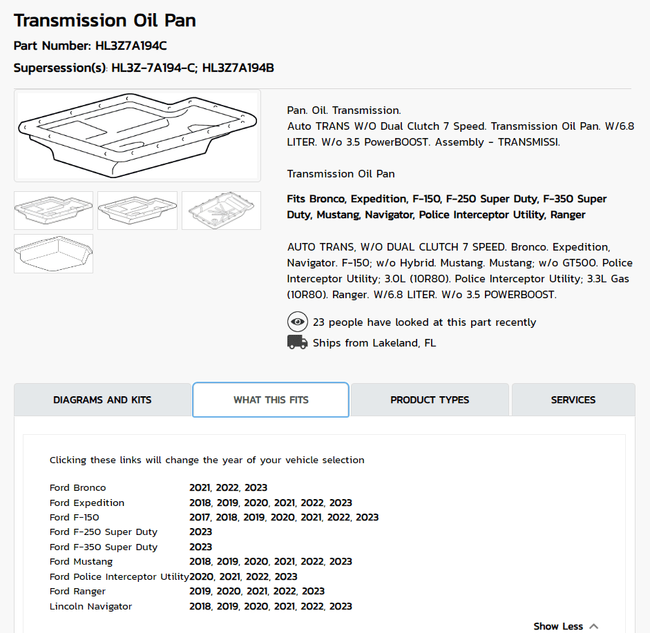

Another generic pan
Ford F-150 High Capacity Transmission Pan 1711663599876-l

What I can say definitively is that the filter for the PB transmission is not the same as the non-PB transmission and cannot be substituted into the non-PB transmission. As to specifically the difference, length, etc, I do not know.
MHT pan has lines that run up to front top of pan
