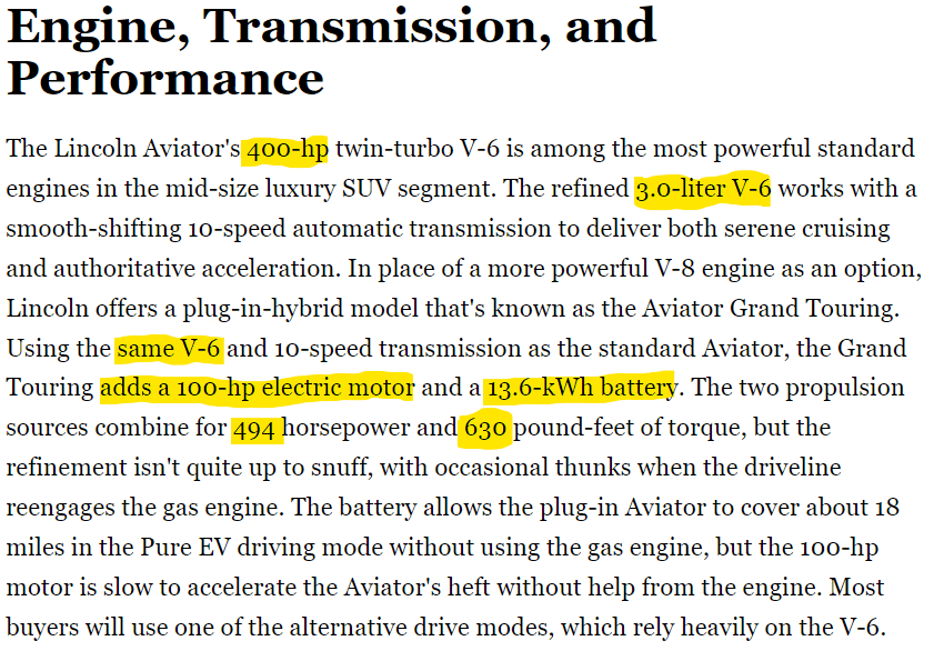

This thread got me curious. My dad has a 22 Highlander hybrid and he was shocked that the PB didn't get better mpg. So I wanted to compare it to the PB and see how it stacked up.
The PB as we know has a 1.5KW/h battery, with 35kW inline electric motor. Vehicle weight 5800 +/- pounds. Lastly the 3.5 twin turbo Eco to round things out. Advertised mileage 23/23 with real world between 22-28.
The 22 Highlander Hybrid has a 1.9KW/h (NiMH) battery with direct drive 40 kW motor (53hp 89 lbs ft) on the rear axle. ICE 2.5L I4 rated for 186 HP. Vehicle weight is 4,553 lb Advertised mileage 35mpg and easily hits 45+ mpg.
So not only does the PB have almost .5 KW less battery but also a significantly less powerful electric motor for a vehicle that weighs 1300 more pounds. I know I know, these are two COMPLETELY different vehicles with entirely different powertrain setups. The point to this is that Ford engineers were very conservative with how they set this truck up. Had they put either a larger battery or stronger DC motor so the EV side did more work it probably would have been a much better match for this truck. Hell they might have even been able to do better with the 2.7 Eco joined to a 50-60KW electric motor and a 2.5-3KW battery. I'd be willing to bet a setup like that would get better mileage and similar performance provided they allowed the EV side to do more work in light to light city driving.
The aviator weighs as much as the PB does, yet it's a smaller vehicle.
Don't forget the Highlander engine has about 190 less HP and it is an utter slug compared to a PowerBoost.

It is definitely not the quick by any stretch. That's for sure.
That 13.6 kWh battery certainly adds a significant amount of weight, that's for sure.
