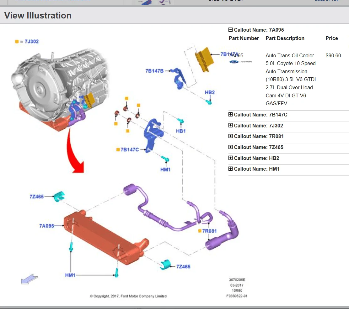

Although Ford did relocate the heat exchanger on the Gen14. Since 2017 it was mounted below and in front of the transmission pan. Right out in the open from underneath.
Orange in this picture:
(you can see it nestled under the bell housing)
Ford F-150 2021 Powerboost High Transmission Temp while on interstate transcool
Now it's tucked up on one side of the transmission. I believe the passenger side?
