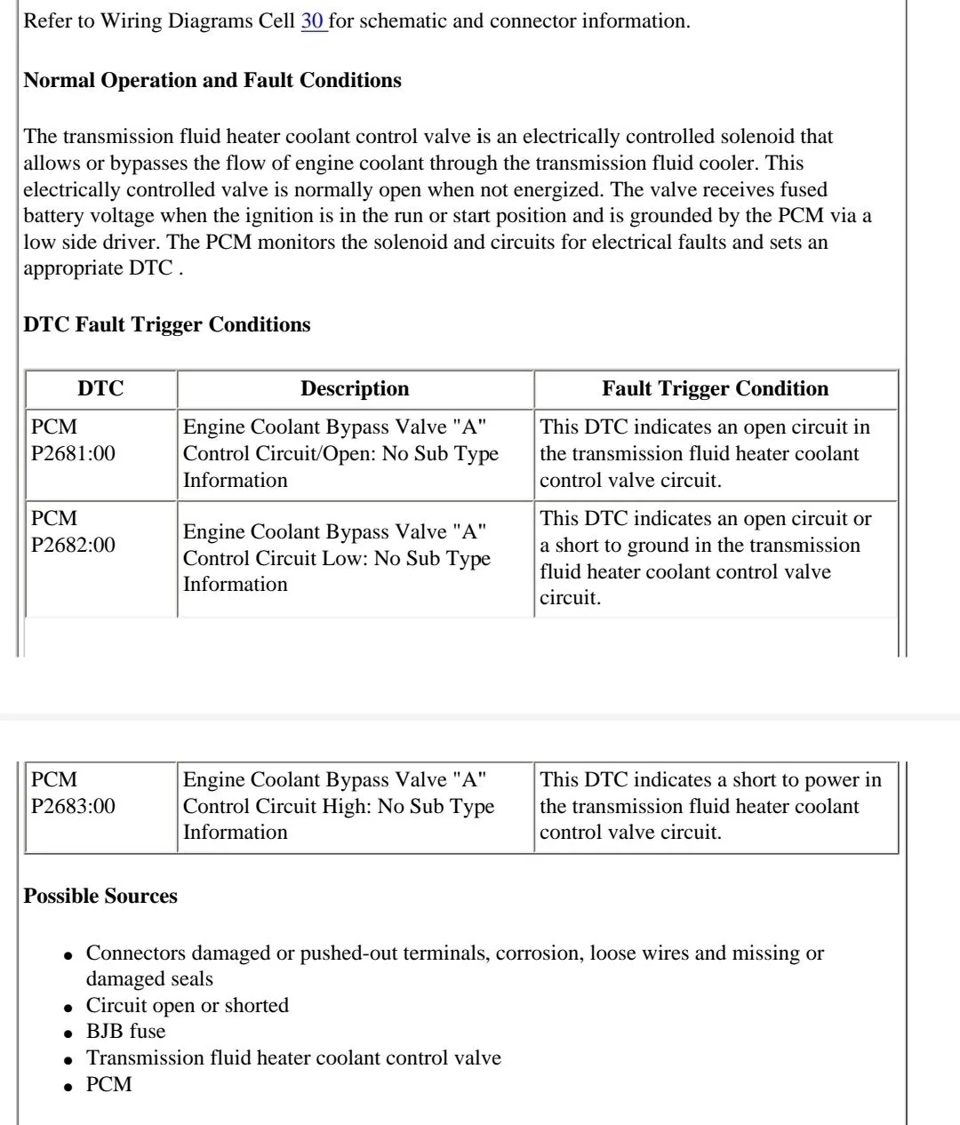

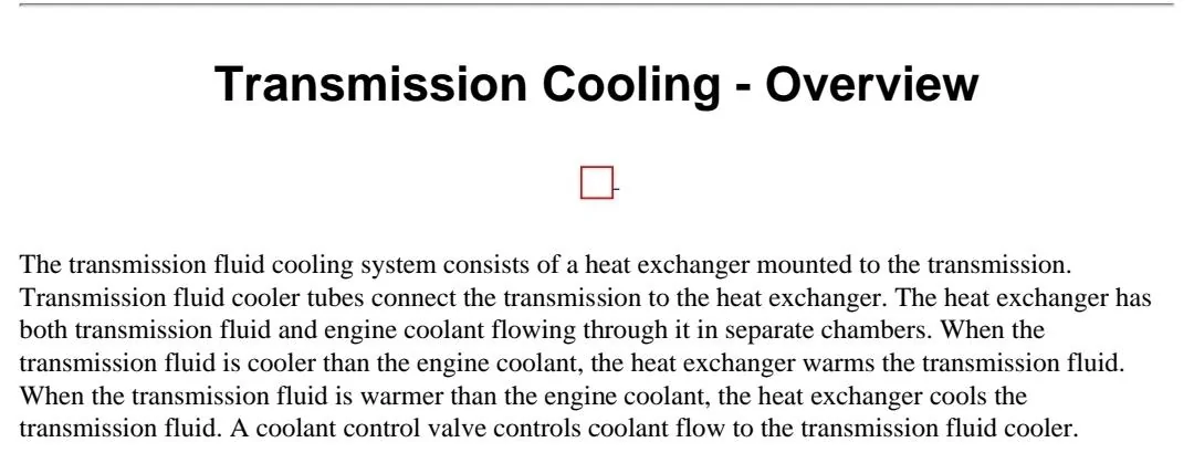

Aha... Dirty contacts, water-in-plug, broken wire, stuck valve... For all of the computer sophistication in these trucks, the fault comes down to the same old stuff... :) Still, is the low load heat output of the transmission so large as to be greater than what can be rejected through the transmission oil pan?
Ford wants it to reach 205F
And it does at about a 20 mile normal empty truck drive.
According to the document, that external engine coolant valve is controlled by the pcm. I don't know if it opens to introduce engine coolant heat into the transmission coolant, or if it opens to let engine coolant remove heat from the transmission coolant.
I do know that when the tranny coolant is at 205F, that's a delta of 10-15F between the 2 liquids.
Also, there is an analog thermostat inside the 10r80 that doesn't allow coolant to flow between the "top" & "bottom" of the transmission until a certain temperature is reached. That's why when you drop the pan you will only get about half the total fluid out with gravity.
If you pull that thermostat out (delete), it's reported the transmission runs too cool and can't reach operating temps.
That makes me believe that the engine coolant is for both introducing AND removing heat from the transmission? And the pcm is measuring the delta and opening/closing the valve to maintain a equalization?

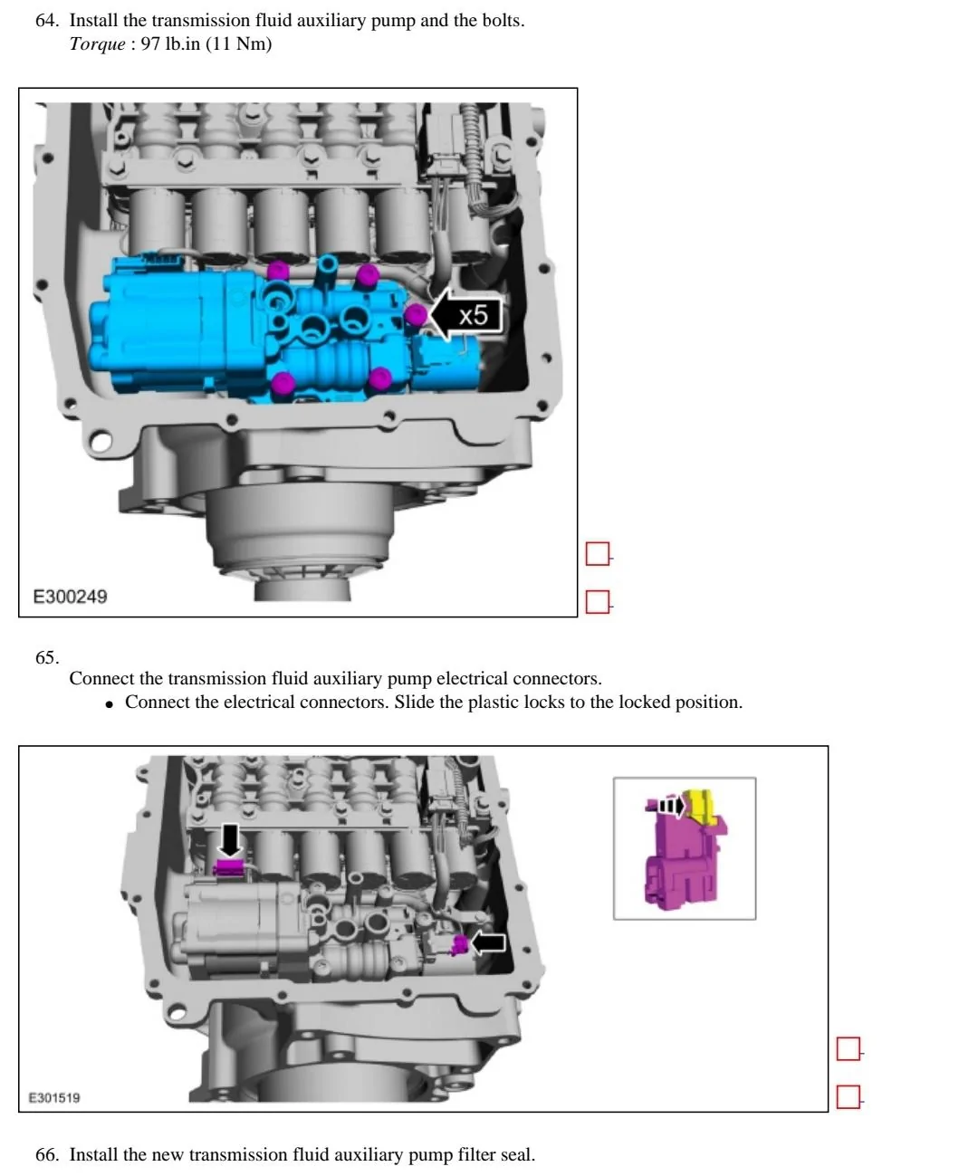

Where's the aux coolant pump that he PBs use?
Do you mean the transmission auxiliary pump? (electric for when ICE is off?)
Right behind the valve body, nestled at the very rear. Blue in this picture:
