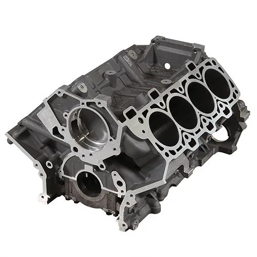

The 2.7 is a good overall package, and was built with boost as its primary design criteria. The block is interesting, utilizing the ladder frame two piece setup. Outside the ladder frame it looks like a 80’s small block whereas the 3.5 & 5.0 both use a deep skirted block (block envelopes main bearings and caps are cross bolted into skirt). What is interesting is both the 2.7 & 5.0 use a partially closed deck reinforced design (which is stronger), and the 3.5 is a totally open deck (not as strong). I was surprised to see that. Looks like Ford definitely knew the boost levels would be high in the Nano motors, and presumed us V8 guys would be throwing blowers on top and/or spinning them up.
I must point out he used old 5.0 power figures when comparing torque. Ours make 410 lb ft @4,250, not 400 lb ft @4,500. That was the 3rd gen, we have the 4th gen engine.
Notice the decks on the 2.7 & 5.0 are both reinforced and partially closed, in contrast to the totally open deck in the 3.5. Builders often deck a motor for more bore strength, so partially closed/reinforced deck is superior from the factory.

5.0:
Ford F-150 Heavy Engine Mechanic reviews the 2.7L Ecoboost engine IMG_5868
Let's all refer back to the recent video where the weak POS Powerboost spanked the 5.0 repeatedly. Partially closed deck got him a full view of the PB taillights.
