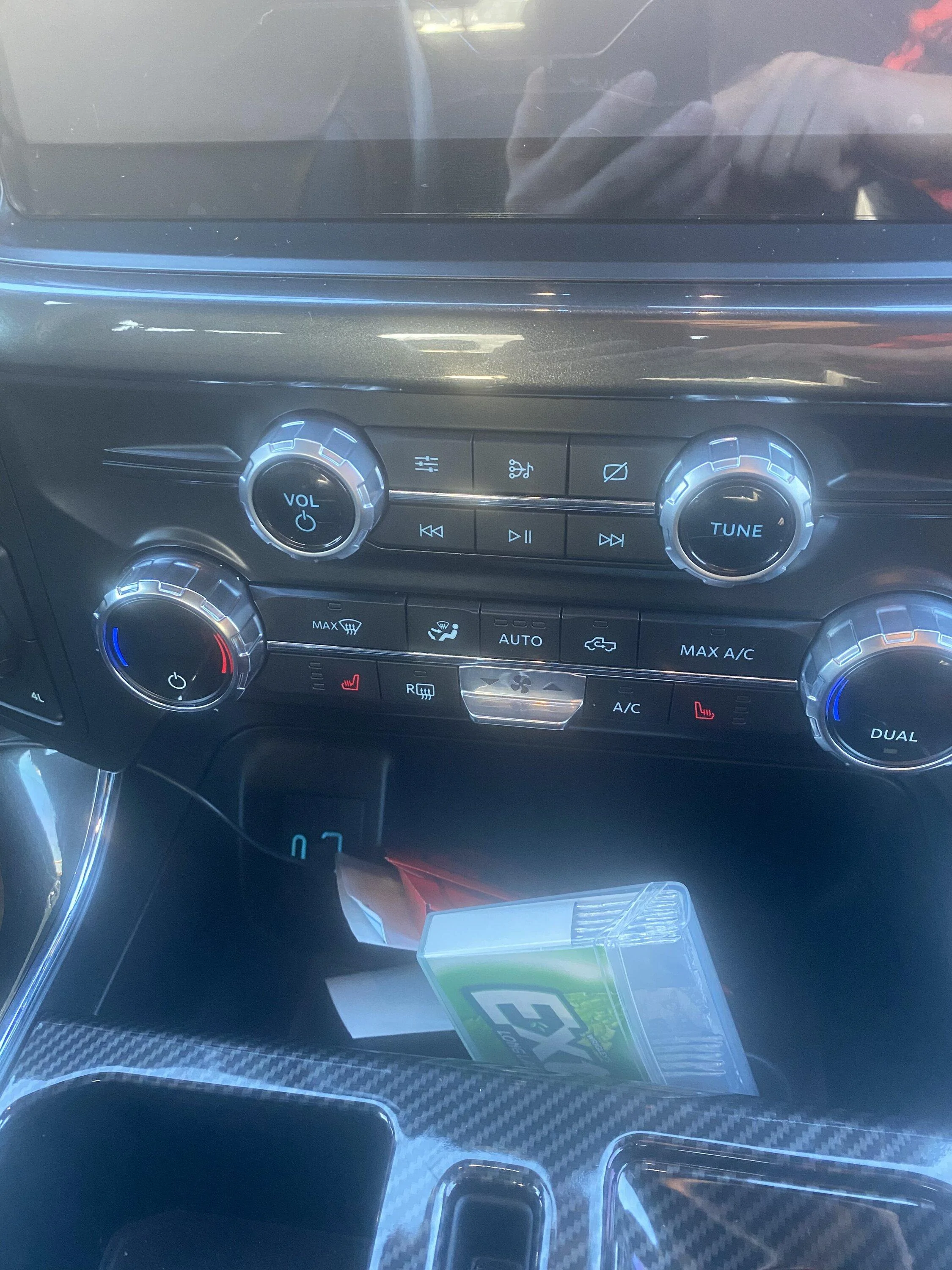

Chavez17m
Marcelo
Dec 4, 2022
Yuba City CA
2022 ford f150 raptor
Contractor
Do you guys know the exact part number that I need for the clockspring for my truck. It’s a 2023 raptor I think it already has a heated steering wheel. I just need the clock spring I already have the new temperature controls with the heated steering wheel button. I’m just missing the clock spring. I have seen some people post that you need the one with the wiper stick and some that I don’t so I’m not sure what’s the exact part I need or part number I need. Thank you
