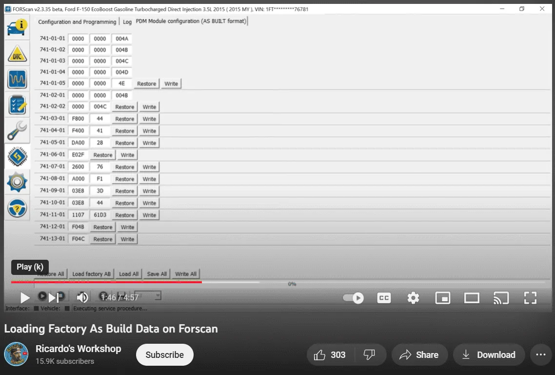

Iv used forscan before but it’s been a while a while. How are use it on my 17 F150. But I never had to program an HVAC before if you could DM me and I could talk to you more about it later that would be great. Because it would be nice to have somebody that I could talk to when I need when I attempt to do this. I have the clock spring and I have the HVAC I just need a time to put them in. I may have the time just to put the clock spring in this weekend.
You can DM me, but I honestly havent done it yet as I am still waiting on my 23 to arrive. From my understanding, you go in to Forscan to write new values in the as-built area (write in the blocks rather than use the quick method - I have never used the quick method). You can then click the "load factory AB" which will put up all the values you need (aside from the ones you need to change in order to enable the heated steering wheel), and then click write all, at which point you have now programmed the module. This applies to both the SCCM and HVAC as you will need to program both of them. The only issue that will arise is that you will get a code since neither of these modules are programmed with your VIN to your vehicle, but this code will not throw a check engine light, it will just show up if you scan for codes. Screen shot below from a YouTube video that shows how to use the "load factory AB" option. Or you can type out all the values yourself rather than use the "load factory AB", either way you will need to write all to program the module.
