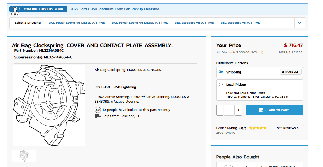

are we 100% sure this is the part number because I put it in for Teske and they say it won’t fit the current model.
Guess you could try this one.....

We're pretty much assured that no '23 model F-150 has active/adaptive steering. At least, Ford would not let me order it. The platinum 701A trim I ordered does have what they call "electric steering" or "electric power steering", though.
For grins I just put my VIN (for my still-waiting-to-be-shipped '23 platinum powerboost) into parts.ford.com and ran a search for "clockspring". A part number "14A664" comes up and it says that fits my would-be truck. It doesn't admit that the part supports a heated steering wheel, but the description is otherwise correct.
What suggests to me that this part is probably correct for heated steering is that it is also the part that parts.ford.com will specify if you put in a VIN for a truck that DOES have heated steering. I dug one up on Autotrader. If this similarly-equipped 2022 truck, that DOES have heated steering, happened to need a new clock spring, parts.ford.com will offer up the same suggestion that it does for my VIN.
I will admit that it can be tough to discern this with certainty because parts.ford.com has a habit of putting only a portion of the part number ("14A664") on the parts listing. However the search results for both trucks offer up the exact same hyperlink, which is also the lone result you will get if you just straight-up search for "ml3z-14a664-b".
So, hey, I don't think there's any way to know with absolute certainty if the right part for this job is ML3Z-14A664-B, until somebody actually gets their hands on one and stuffs it into a '23 F150 with "STEERING WHEEL - HEAT REMOVAL" on the sticker, resulting (with suitable related tinkering) in steering wheel heat. AFAICT nobody's done that yet. I will certainly buy the first ML3Z-14A664-B that I can find, and (if the truck ever shows up) will give it a shot.
At least it now looks like a clockspring and an HVAC control module (plus the one-time use bolt) may be the only parts required.
