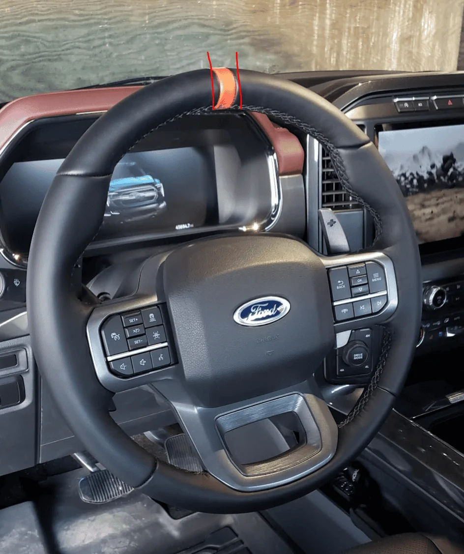

Heated steering wheel has a small cold spot, is this normal?

Ah ha. I kind thought this might be the case, since obviously they need to start and stop somewhere.
Thank you for checking.
So either they just didn't fully complete the circle or the element at the very end is broke.
Hmmm, now what to do or not to do.
i only noticed it because you posted about it otherwise i probably would have figured that seam in the stitching was absorbing heat or something
i retrofitted my heated wheel so nothing can be done in my camp. my bet is that more wheels are like this than not
My cold spot is right here but that is kinda self explanatory why so
I've got the same exact wheel -- haven't noticed a dead spot up top, might take the FLIR to it.

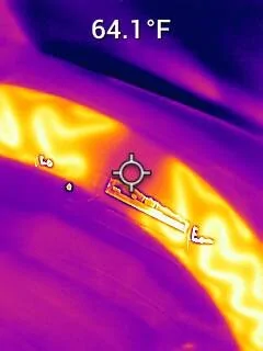

Yeah, it's a dead spot, image 2.

In some pictures your wheel is 37 and others 69. Those numbers are all over the place.
Don't rely on those, I wasn't trying to register the temp, just show the thermal profile. While you can see slightly warmer within a single image, I didn't have the range locked so you can't infer temps between images. There's a sweet spot where everything lines up and you can rely on the temp reading, but that wasn't it. It's parallax issue between the sensors. You can see the visible light camera overlaying an image on top of the thermal camera to get an idea of how the parallax affect is.
Take this issue, the thermal can't see the dash behind the wheel while it's displaying it.
I gotcha, thanks for explaining it. Pretty cool camera.
