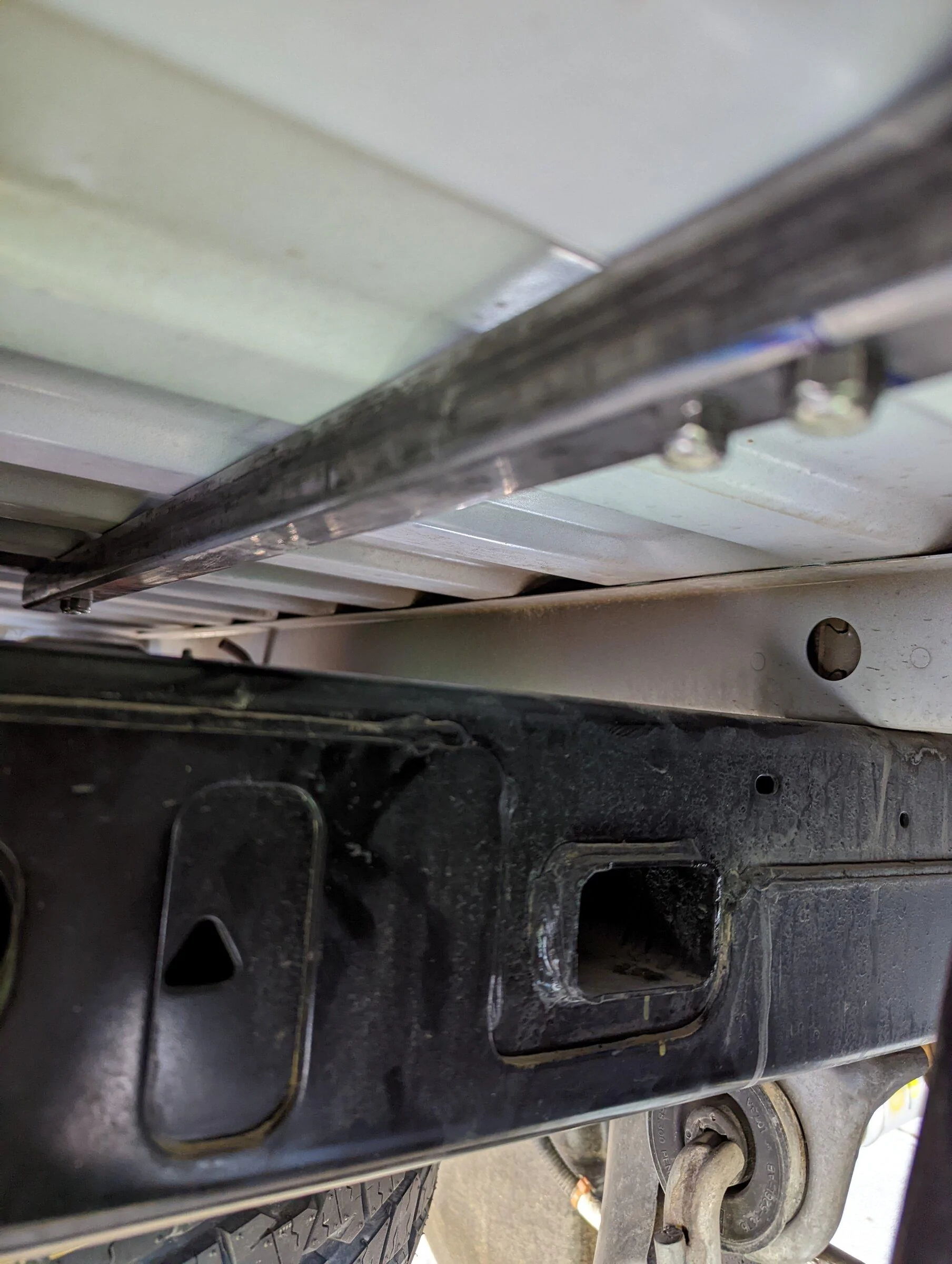

I splurged on the Ford factory loading ramp, which slides into a keyway in a replacement tailgate panel and love it... it can't slip off the tailgate! Also bought an extra set of L-track "pucks" for my Bike Binderz, which I use in my toyhauler and love them too. I had a 36" scrap piece of 1" square steel bar that I used as a backer plate (pictured). Not sure if you're hauling dirt bikes and I know you don't want to drill holes in your truck bed (yet), but this is the easiest/fastest way to secure dirt bikes I've found...

hey man thanks for all the pics!! that setup looks great! is that the OEM stowable loading ramps? they're like $1400!! they look really convenient but i was worried about ground clearance
is that two ramps joined or is that one ramp side that extends? do you know the length

Yes, it's the Ford OEM/factory loading ramp setup. I think the price for a single ramp kit is more like $600, but I happened to find it all lightly used off Craigslist in town for $200. The Gen 14 tailgate panel is the same as the Gen 13 tailgate panel, so if you find a used one off a 2010-2020 truck it should work fine for your 21+. The kit comes with 2 ramp storage brackets that hook into the BoxLink cleats on one side, so the ramp doesn't slide around in the bed like an aftermarket ramp. Yes, the pic shows the ramp extended to full length, but it has a nice quality pin that you pull to adjust to multiple lengths. If I remember right it says "Max Weight 800 lbs" so a sport bike would be fine too. I'll try to measure the length tonight, but dimensions should be available somewhere with a Google search...
The Bike Binderz only attach to the pegs (no straps to handlebars!) and they are REALLY well made and kind of expensive but they'll last a lifetime. Bike has never moved, whether in the back of the truck or in the toy hauler. I purposely mounted the Bike Binderz farther back in the bed so the front tire clears the rolled up BAK X4s bed cover so I don't have to remove it to haul a bike (y) The tailgate won't close like I'd prefer, but the tool/water/storage platform I built keeps gear bags and coolers from sliding out out the back... so far.
If I have to haul a second bike in the bed, I'd use straps and the lower box tie downs likes @ryanc111 said. I wouldn't trust the 4 little BoxLink cleat screws if you happen to hit a sweet jump with some bikes in the back :ROFLMAO:

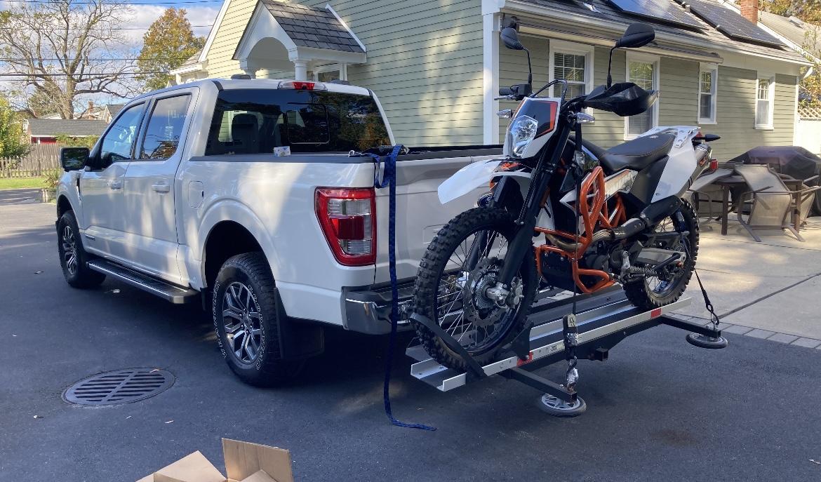

Coming from an 8’ bed on an F250, which was ideal to transport bikes, I always found myself alone when I wanted to get the bike up there. I bought this hitch mounted bike carrier and when I sold my former truck and settled for the silly 5.5’ bed, which is pretty useless this carrier comes in pretty handy for the bike and other items needing transport. My KTM is a little over 300# and I can get it up there pretty easily. Never into the bed, that would be painful. This works for me.

whats the tongue weight on the f150?? these always seemed sketchy to me but looks like its working well for you!

Depending on which hitch you get, it’s up to 500lbs. Though mine says that’s with weight distribution hitches, I have no clue what that means for one of those cargo/motorcycle/mobility scooter racks.
As long as you are within your GAWRs, you might actually have better stopping distance with it hanging off the back of the truck like that!

I have no idea what the tongue weight rating is. I wouldnt believe it anyway, most numbers are skewed anyways, then try to figure out that number when its stretched out 18" from the pin you will have some other number. This carrier has been on my wifes Tahoe, and several other vehicles with no issue. As long as I dont have to push a bike up into the bed again, this will be my go to.
The carrier itself is rated for 600#. I have seen them bolted onto the rear of motorhome bumpers with heavier bikes then mine and still going. Nothing sketchy, just ease of use. Theres no way I would use ramps again, especially short ramps of any kind, unless I can easily walk it up, with the ground level helping me. Just asking for trouble unless you have 3 people who are all 6'+ tall each.
