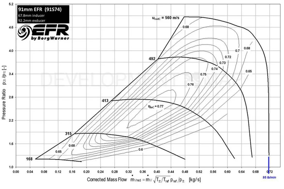

The pressure needn't necessarily increase, a more efficient turbo can move more air mass at the same boost pressure by heating that air less than the stock turbo. But yes, there's surely a decent amount of safety margin built in to the engines.
^^^This
Turbos aren't just a linear "more boost!" component. Here's a turbo efficiency map for example.

For those interested in further reading

Yep, it's advantageous to operate as much as possible in the "islands" that represent high efficiency. The smaller the island, the more efficient the compressor is when operating there. Put differently, the less heat the compressor is adding to the air being compressed, so the more mass is flowing through the system (since cooler gases are denser at a given pressure). More air mass means you can burn more fuel, so more powah!

Speaking broadly, bigger wheels stuffed into smaller ported housings can often flow a LOT more than the original setup did. Such things are often very well worth the trouble. Prime example: I have a mid frame (T4) turbo with an 88mm compressor wheel. Precision Turbo rates it as supporting 1250 hp, and their ratings are often a bit conservative. They also make a 91 mm version, I forget what it supports but it's no joke. I think this family of turbos started out considerably smaller, just an example of how far these things can be pushed sometimes.
