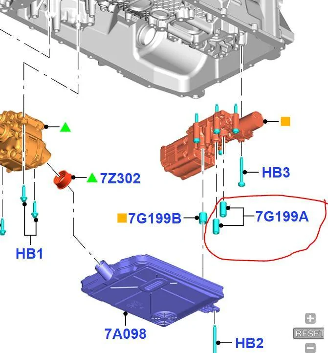

Are you going to do this yourself? I'd replace the filter while you're in there as well as loosen the valve body bolts to drain it. That should get you ~11qts or so out of the trans. Also I'd buy the 2 rubber jumper hoses that go between the pan and the aux valve area.
Hybrid has a unique filter FT217
2 of these BL8Z7G199A (little rubber bridge things)

The little hoses are here -- those go to the motor spray bar to cool it and control the hybrid clutch.
If I had a hoist at home I would but the hybrids are not fun to take the transmission pan off. the 10R80s on previous models were a cake walk compared to these things to remove. the cats and the y-pipe have to be dropped which means dropping the transmission rear crossmember under the transfer case just to drop the pan. the pressure sensor Ill take care of but going to have to send it to the dealer for the fluid pump. along with the fact the QR code on the pump needs to be programed into the PCM and a parameter reset needs to be done all with the ford FDRS

I kind of wondered about that, I used to be a ford mechanic for about 10 years till I got my current job so I'm not unfamiliar with working on them and I was always pretty good and finding easier ways to go about doing things without damaging anything but the problem still remains that the aux fluid pump has a QR code on it that needs to be scanned and then the number needs to be put into the PCM programing before it can be driven so regardless, I have to get my dealer to do it as I don't really have access to the FDRS to use it for a weekend job in the driveway.
Hrm, are the 2 additional solenoids part of the pump? You can enter that type of data w/ forscan.
just following the ford WSM as far as instructions go. forscan might work IF it has that capability but I still have the same issue... no real weekend access to a computer with FDRS or forscan loaded on it. I'm definitely capable and have had an extensive amount of ford in school training but never got the chance to do any in depth transmission, let alone hybrid trans. training. I was the diesel tech for 10 years with ford. left ford at the tail end of 21.
