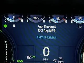

The PowerBoost doesn't employ conventional auto start/stop. The truck transitions smoothly from electric to hybrid drive in most modes, and immediately when your foot lifts off the brake in sport/tow haul. I have no idea what the passenger was complaining about. To date every passenger I've had marvels at the vehicle operation.

That is my experience with my daughter's PowerBoost. I learn a lot in these forums.
