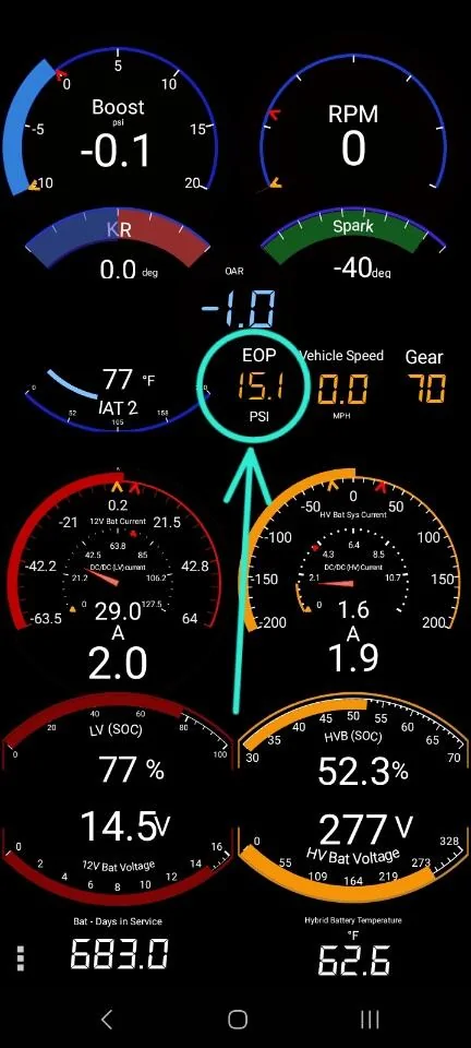

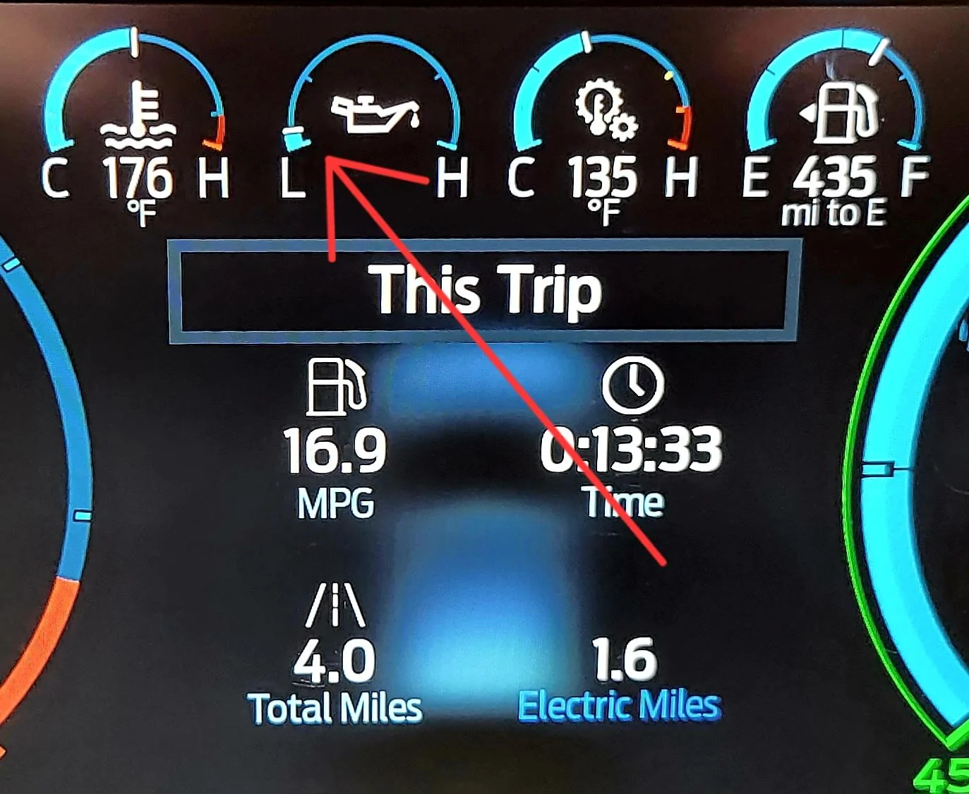

My Powerboost oil pressure drops to zero when in ICE off mode.
Are you saying that your oil pressure gauge doesn't show sustained greater-than-0?
Ford F-150 Starting Engine from a Stop 20240221_094335
The oil pressure PID supports the visual gauge
Ford F-150 Starting Engine from a Stop 1000021230
Like I said, it goes to zero. Recall that this is a switched output. The switch is either on or off. It is not a pressure gauge of some kind.
Yes, I'm aware that the gauge is a dummy. The pressure switch is a 7lb yes/no switch. But why would your Powerboost dash gauge read differently than other Powerboost dash gauge?
No idea. Awhile ago, I think it was you, raised that point about a few PSI engine off... So I went and looked. My dash is a somewhat different layout than yours.
It may not be too hard to probe the sensor. See it the key off reading is the same as ice of ev on.
Key off is 0 psi
The oil pressure sensor on the Powerboost/Ecoboost is the same since 2017.
It's not a pressure reading sensor, but rather a on/off yes/no open/close sensor set for 7psi
The gauge on the dash is as fake embedded animation. And that's true for the Gen13 as well.
What we have never been able to discover is what drives the oil pressure PID. Most consider it a calculated value, similar to exhaust temperature PID. There's no physical probe to measure exhaust temperature. There's no physical sensor to measure oil pressure. But the PCM absolutely reports both values.
