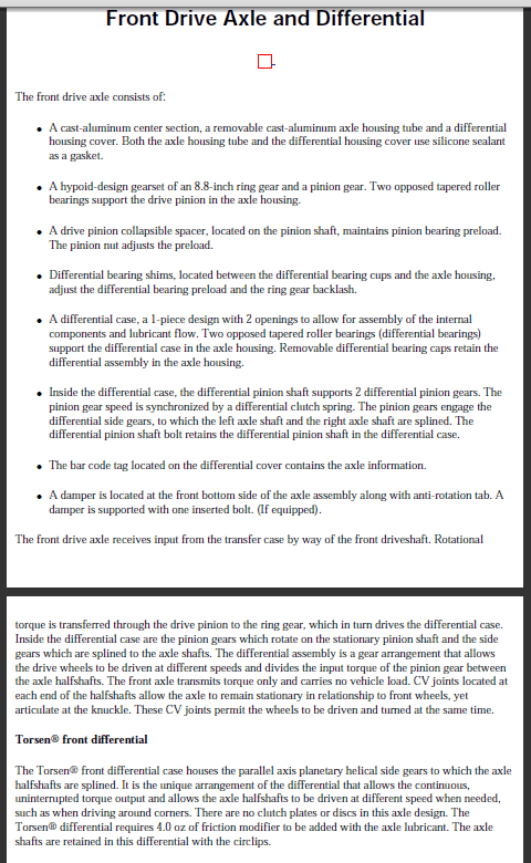

Looks like it does require it for the front. Below is the info out of the 2021 Service Manual.
2021 F150 XLT FX4 5.0L

If I’m reading that right, ONLY those with the Torsen need the friction modifier.
Only if you have the Torsen though, right

The only trucks that are factory equipped with a Torsen front differential are Raptors. All other F-150's are equipped with an open differential. So if you're truck is an XLT it uses the lubricant as listed below.
205-03 Front Drive Axle/Differential 2021 F-150 Specifications Procedure revision date: 06/11/2021 Specifications Capacities Item Types of Axle Liters Material : Motorcraft® SAE 75W-85 Premium Synthetic Hypoid Gear Lubricant / XY-75W85-QL (WSS-M2C942-A) Conventional 1.83 qt ( 1.73 L) Material : Motorcraft® Ultra Silicone Sealant / TA-29 (WSSM4G323-A8) - -

As a tremor owner who paid for the Torsen, it’s not just raptor owners with a front Torsen diff.
