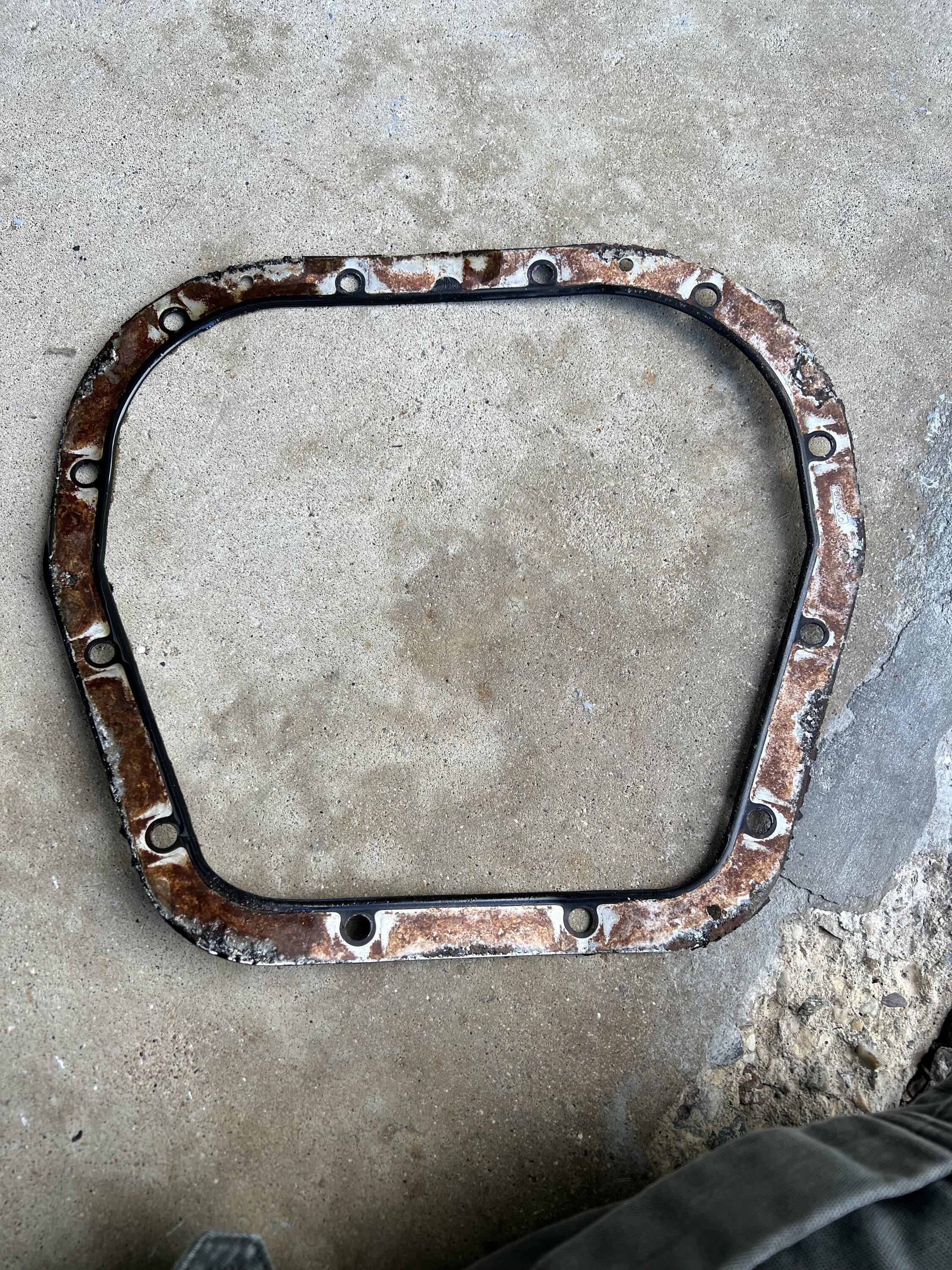

To start, my differential had a metal gasket and o-ring. As shown in the photo, the o-ring is on the inside of the gasket.

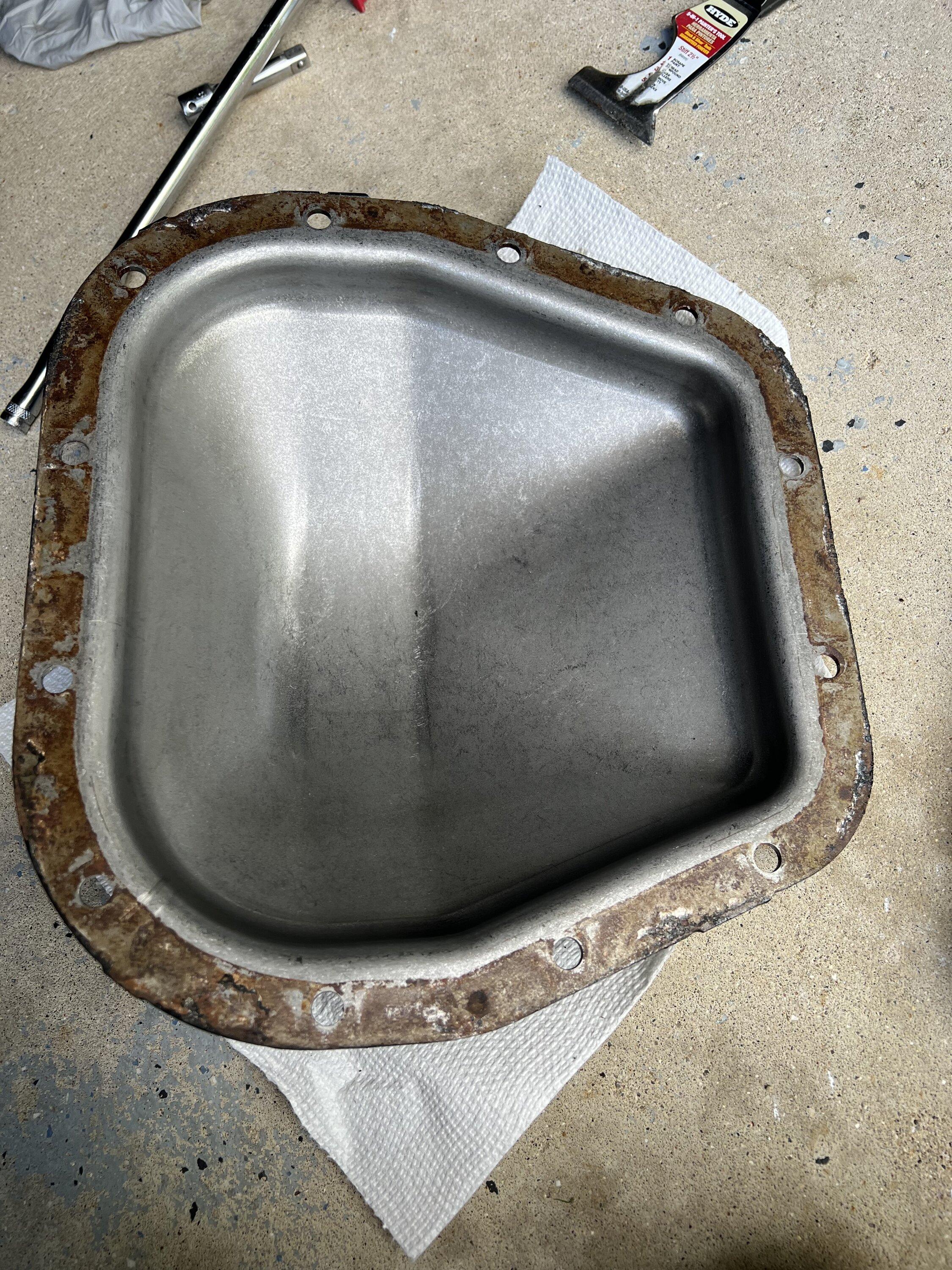

This photo shows where the gasket/o-ring seals the differential on the cover. Note the large amount of corrosion that has formed outside of the o-ring.

Cleanup of the surfaces took a while due to all the rust. The black is POR I used to coat the rusty axle. It proved to be most difficult to remove. I found two gouges in the cover left by the stamping process.
