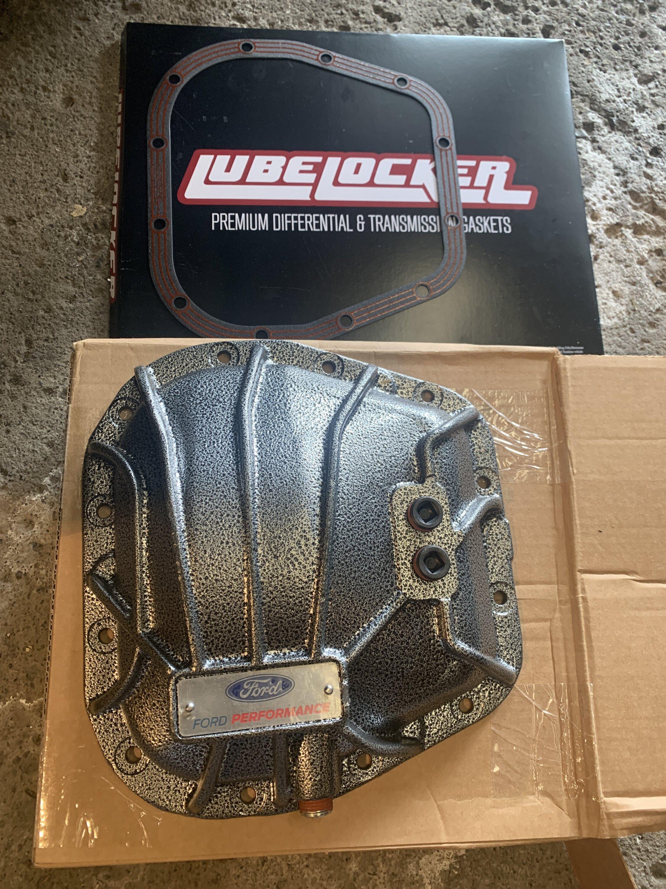

I used Amsoil, was dirty black at 2000 miles. Lubelocker makes nice gaskets with 3 layers of impregnated RTV.
I also have the 9.75 rear gear, Ford Racing makes a nice cover with magnetic drain... They have this also for super 8.8
Ford F-150 Diff Friction Modifiers? ?force-system-browser=1
Get all of the old RTV off, shiny clean before installing.
