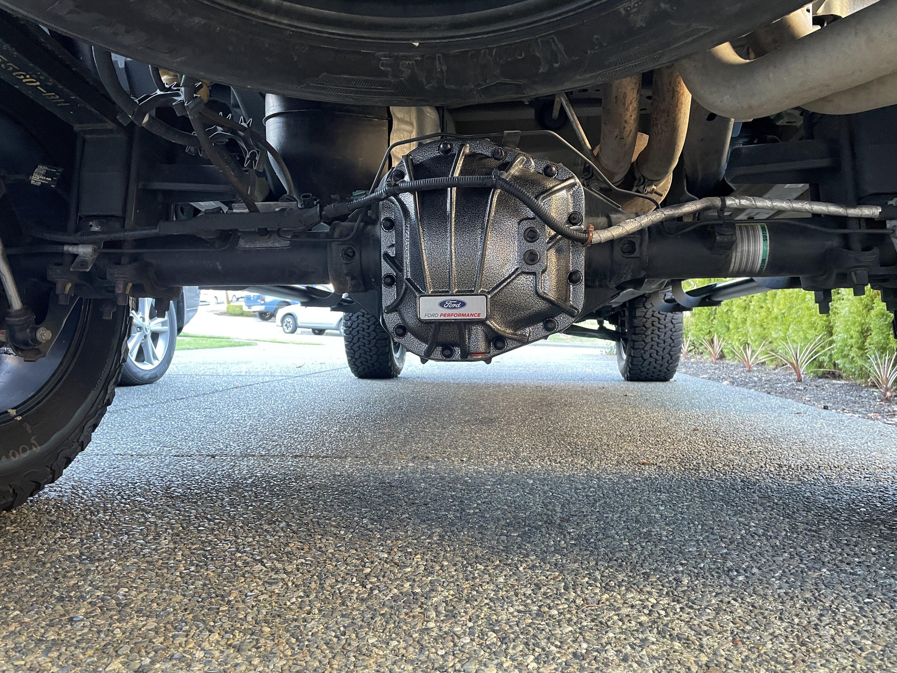

Had fun working on my truck this weekend. I ended up getting a PPE transmission pan for Christmas along with a Ford Performance diff cover for my 2021 F150 5.0L Rocky Ridge K2. I used a LubeLocker gasket with the diff cover, very simple install. One detail though, if you use this or the Spicer diff cover (same thing except for logo's) use the factory bolts. The ones that come with the covers are real weak.
For the PPE pan you need to unbolt the trans from transmission mount for the 5.0L and lift it about an inch to get the old pan out. I ended up buying and using a new Ford gasket just in case my original was damaged. I also added a new filter and seal since the pan was off. Turned out good.
