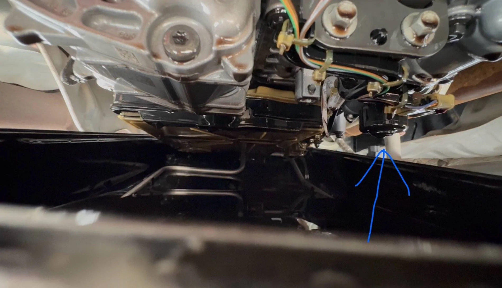

I did this today but with limited success. I could not get the pan to clear the exhaust cross tubes. I think the hybrid components were in the way at the rear end of pan.
I went in to replace the parking solenoid and was lucky that there was just enough space to access it with the pan kind of hanging forward.
There was no chance of getting to the filter bolts so I put it back together and top off the fluid.
Did you have to move the cross tubes or jack the transmission to get your pan to drop off all the way?
Here’s a pic of my experience

Did you try to pry the exhaust back w/ a crowbar to buy distance from the trans?
21pb
S
Feb 6, 2022
Ontario
2021 F150 PB
It seems pretty ridged when I pushed it up with my hand. I would be scared to pry it hard enough to make enough clearance.
I actually meant to make this post in the other thread linked above
