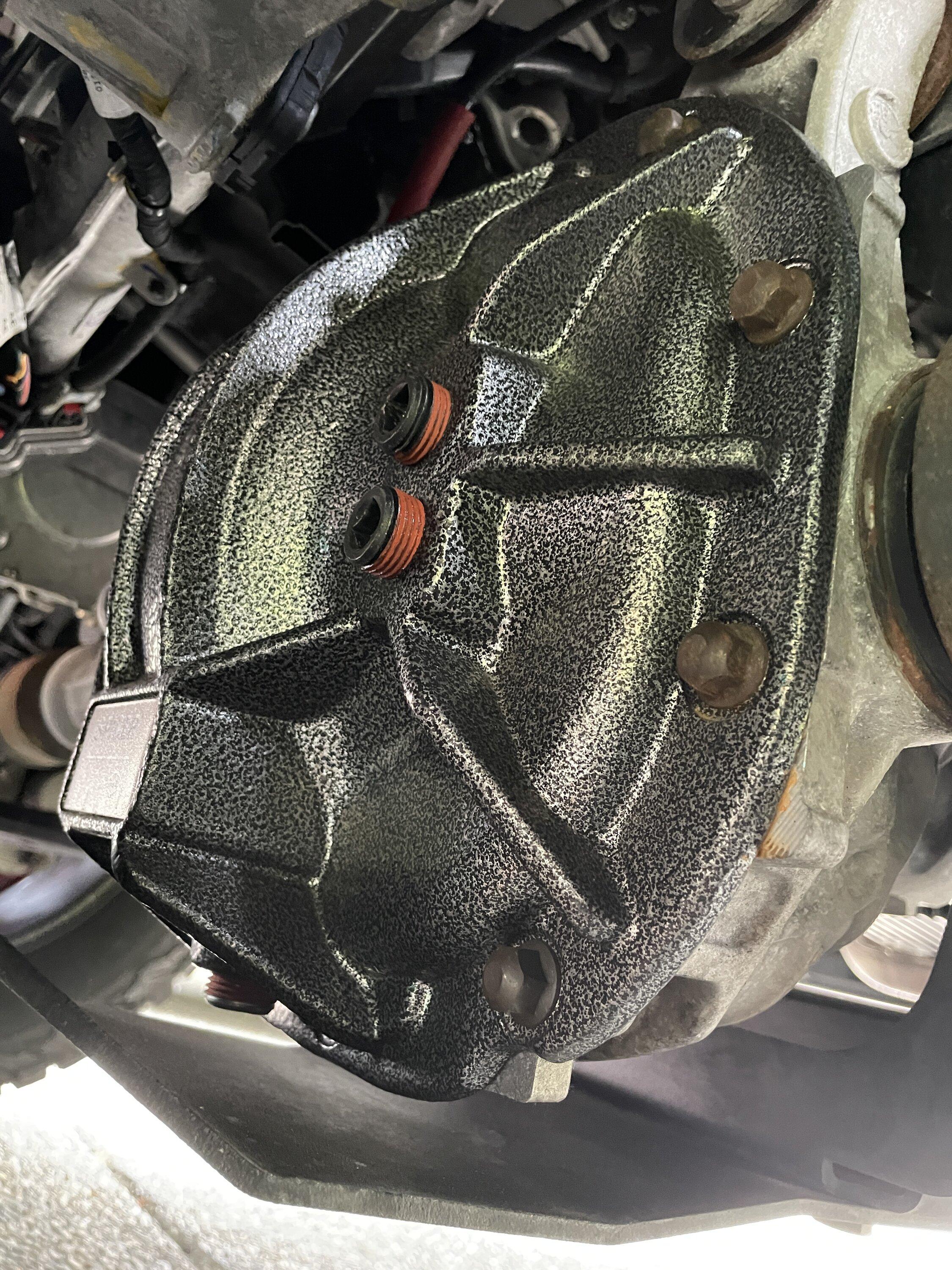

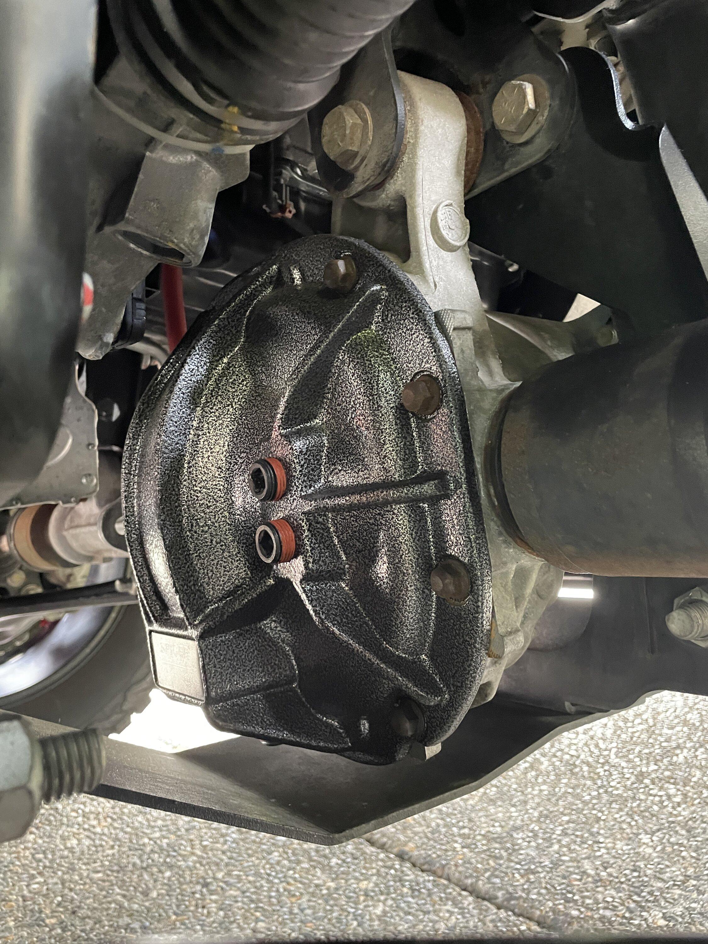

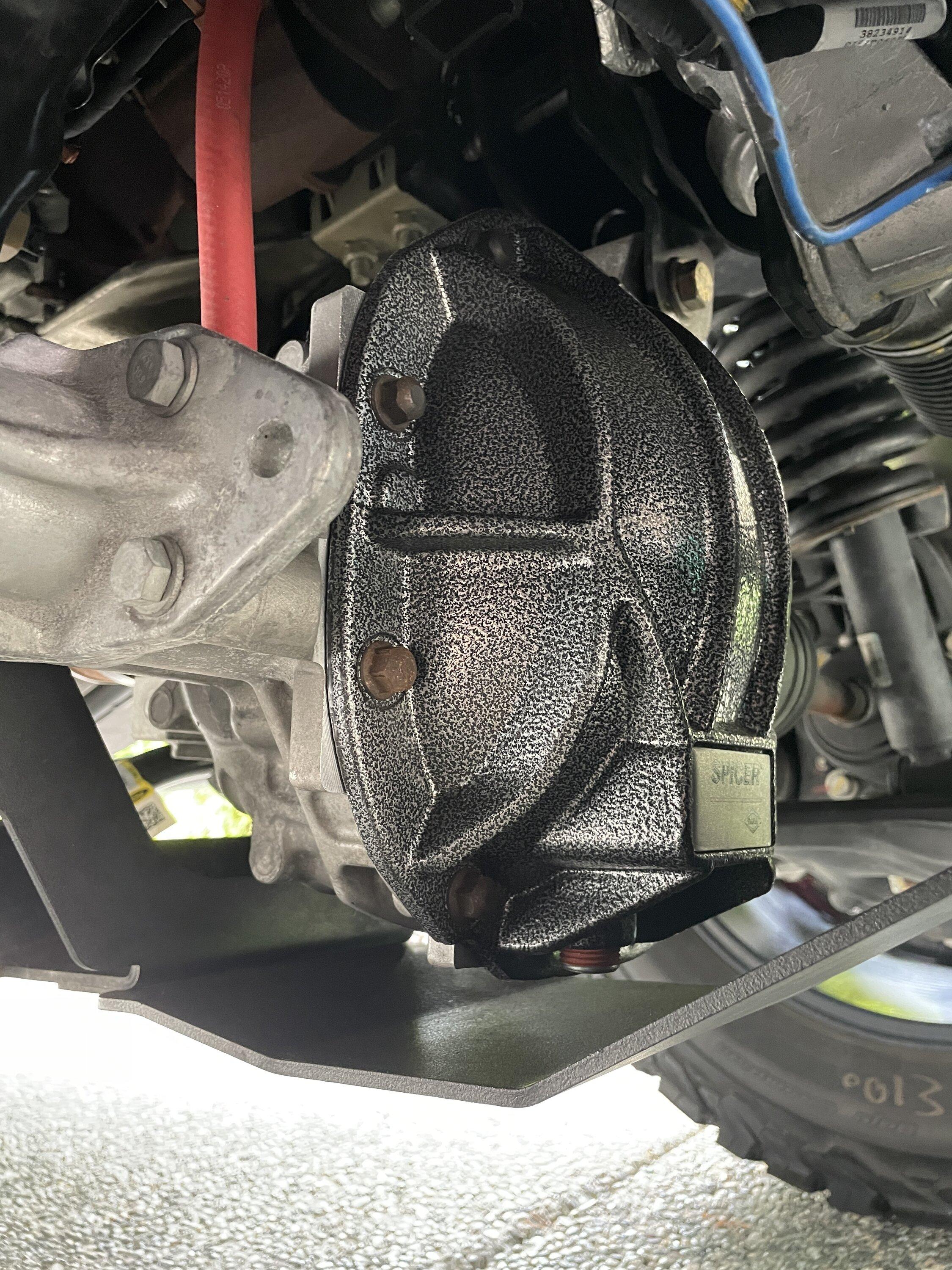

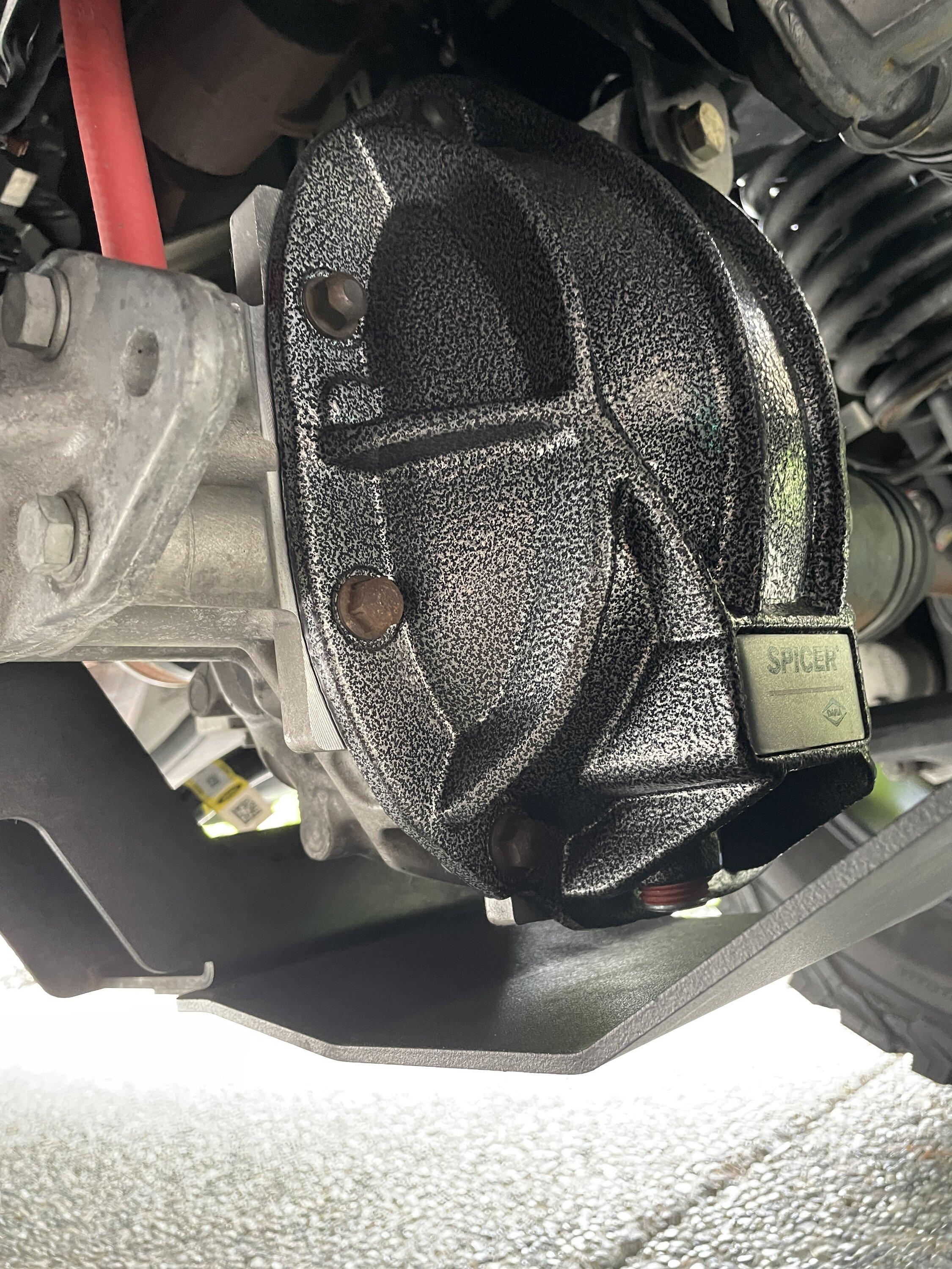

Ended up changing the front diff fluid and was able to use the spicer 8.8" diff cover and lublocker gasket. (With a 6" lift)
I'm so glad I did this as the fluid appeared to be a tanish gray color (only 6k mi.) and was under filled. Not sure if water made its way in somehow or what, but the vehicle did sit for 5 months during chip shortage. 2/2021 to 7/2021.
I really don't trust the fluids coming from the factory fills. All my fluids in my truck have been changed with the exception of coolant.
So I can confirm the spicer 8.8" rear differ cover works on the 2021 FRONT Diff\Axle for lifted trucks. (mine is a 6" lift)

A few folks were asking so here are some pics of the front 8.8 spicer diff installed….
