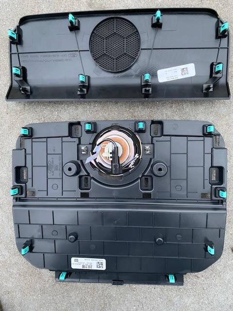

Found a plug under center dashboard tray

in my 2022 STX Found a plug under center dashboard tray. Not sure what it does.
is it power or sound ? If anyone knows
Since no one else asked ,just curious as to why you removed the top panel to start with?

I was looking a way to add USB port up there. Doing research before I ran the cables. Also was considering to power my Midland Radio up there.

Maybe this will help with how it is set up . I was removing it to see what head was used on the nav sat delete. Your photo helped me to see that you do not need to tear the whole dash apart to remove the head unit (ACM).

that is very helpful thank you!

Plugged in a center speaker by FoMoCo. Nothing coming out of the sound at all. So the wire is not active.
Hi... Were you able to fix the center speaker. I have 2022 f150 STX and planning to buy center speaker from ebay. Some people say that you have to program ACM. I don't know anything about ACM.

There is definitely an option to enable/disable the center speaker within the ACM using forscan.
Yes, needs enabled to work

I am defiantly going to find a used center speaker to test this out.
any old speaker of the same impedance will due for testing purposes (although if you pump 20W through an old transistor radio speaker it may well blow, catch fire, or . . .).
But as long as the speaker can handle similar power, it will answer.
A side issue, though, is that if you have anything more than a simple left/right stereo pair , it's going to throw off the balance, even if it works.
it could have been a power source.
that's easy to test: probe with a multimeter set to AC (so you don't have to worry about polarity, and in case it's a signal). If it's a steady 5, 9, or 12-15v, it's probably power.
