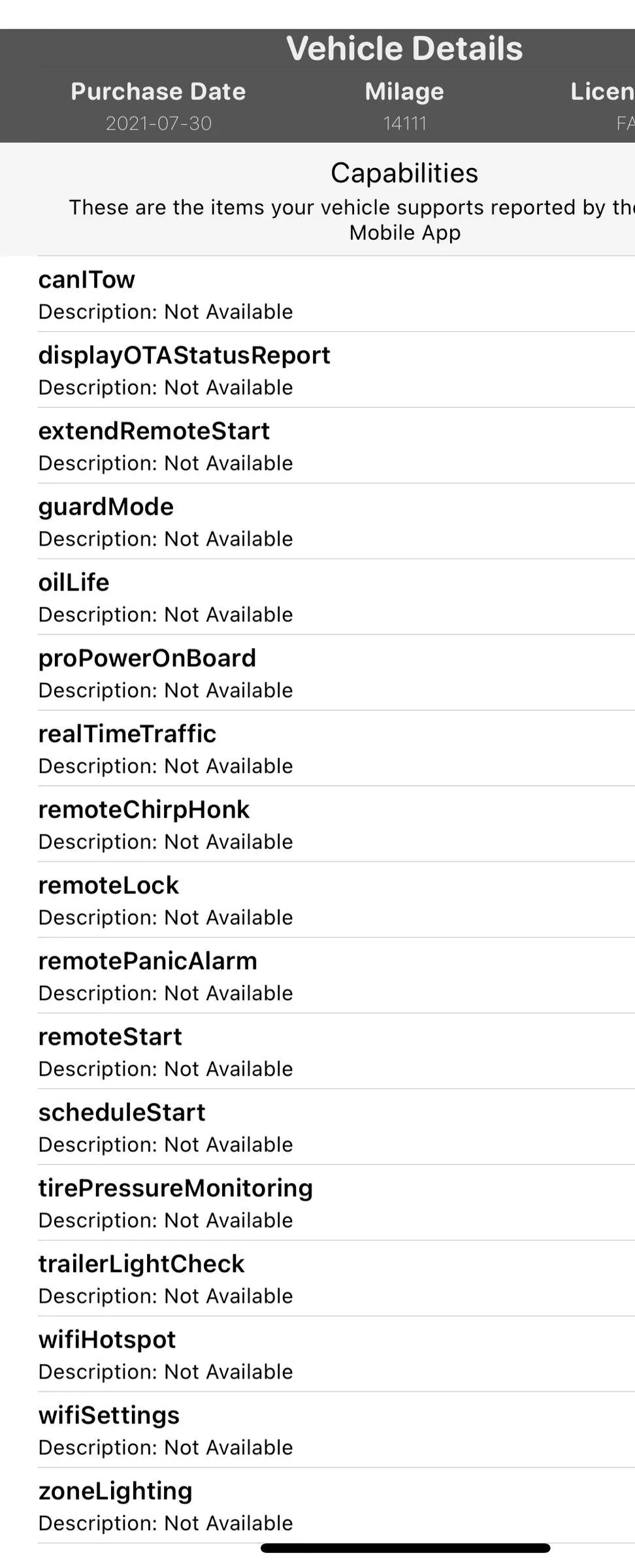

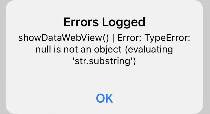

New version seems to be working good. Couple of lingering items,
1. Under advanced info the view all data option doesn’t work. Nothing pops up until you exit the widget then an error is thrown
2. Under advanced info the view more details option doesn’t show updated mileage
3. With my F150 and a full tank of gas the level shows - - instead of 100%
What error are you seeing for an error?
As far as mileage goes I show what ford shows.
Can you share your data with me when your tank is at 100%?

Will do. Here’s the error and the difference in mileage. Mileage on main is right, Vehicle details is wrong.
