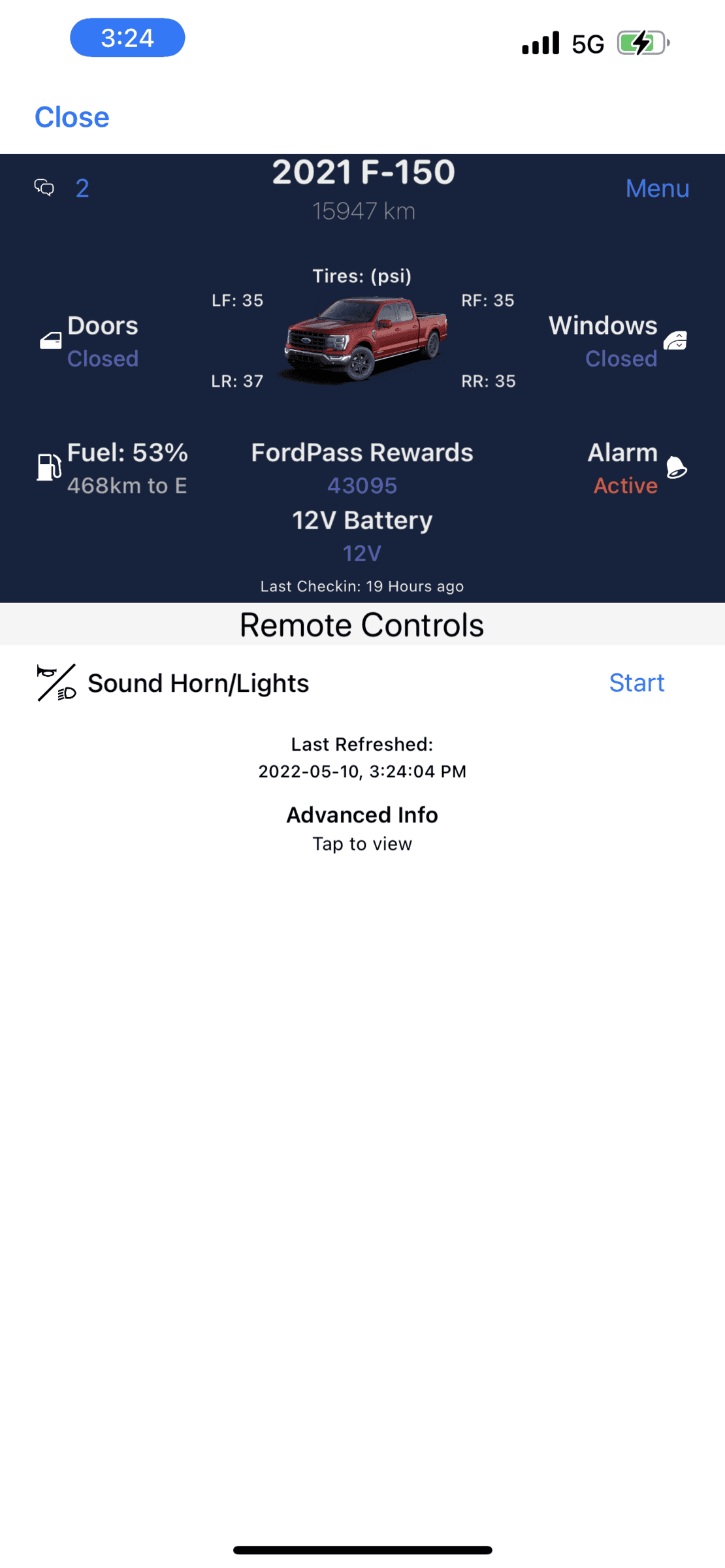

So app not refreshing at all today. Not sure if ford changed something but the app is now 19+ hours since refresh. I have reset, removed, reinstalled all without any change. Also reported capabilities is now a third of what it used to be and main widget screen is missing alot of information now.
Same for me - FordPass app is updating, widget is stuck yesterday despite efforts to trigger a refresh.

NOTICE:
Ford made a backend change to the capabilities endpoint (removed it) so I need to find an alternative.
I will get things fixed as soon as possible...

FWIW, the actions (lock, req refresh, zone lighting, etc) still seem to work, just receiving data.
Yes, commands will continue to work.
This breaking change will end up being a good thing!
I’ve already found a new source that will end up eliminating multiple other endpoints.
