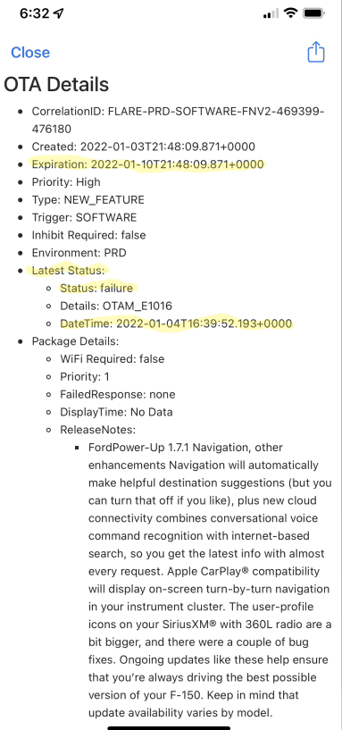

I was reading up on the forum and found where there is a widget to add to your phone that provides you more info than the standard FordPass app. First of all, very cool for whoever made this and shared it for free.
Unfortnately, I saw instructions on the installation but I'm still winging it on how to use it. In the Debug menu, I see the OTA API Info and it looks like it gives you details on your OTA updates. Does anyone know how to decipher the coding below? My best guess is that it tried to update to 1.7.1 yesterday and the update failed, and I'm hoping it continues to try and update before 1/10 when the update expires. Is that the correct way to read this, and is there anything I need to do to make sure it does not fail?
Screenshot below, with some of the lines that seem important highlighted:
Ford F-150 FordPass Widget - Need help understanding OTA API Info 1641429786066

I'm sitting with the same status, only difference is my last date tried was 12/23

Pretty much what "inspect" tells me on the Ford Owner site, with a deployment on 23 December and expiration on the 30th.

Mine is basically the same but shows Dec dates…
OTA Details
  • CorrelationID: FLARE-PRD-SOFTWARE-FNV2-469399-471624
  • Created: 2021-12-23T18:54:34.404+0000
  • Expiration: 2021-12-30T18:54:34.404+0000
  • Priority: High
  • Type: NEW_FEATURE
  • Trigger: SOFTWARE
  • Inhibit Required: false
  • Environment: PRD
  • Latest Status:
    • Status: failure
    • Details: OTAM_E1016
    • DateTime: 2021-12-24T13:19:12.270+0000
  • Package Details:
    • WiFi Required: false
    • Priority: 1
    • FailedResponse: none
    • DisplayTime: No Data
    • ReleaseNotes:
      • FordPower-Up 1.7.1 Navigation, other enhancements Navigation will automatically make helpful destination suggestions (but you can turn that off if you like), plus new cloud connectivity combines conversational voice command recognition with internet-based search, so you get the latest info with almost every request. Apple CarPlay® compatibility will display on-screen turn-by-turn navigation in your instrument cluster. The user-profile icons on your SiriusXM® with 360L radio are a bit bigger, and there were a couple of bug fixes. Ongoing updates like these help ensure that you’re always driving the best possible version of your F-150. Keep in mind that update availability varies by model.

So I assume you still do not have 1.7.1? I made sure mine is connected to wifi every time I park so that hopefully mine will finish downloading before the 1/10 expiration listed on mine.

No, that’s as of today. I am going to try leaving it off Wi-Fi to see if that helps any, dealer appointment in the 17th.

One thing that I've noticed is that I have gotten the updates when my truck is NOT on wifi. Granted, I only have two data points, but I've only downloaded the updates when it's been parked away from my house in the evening.
I have my home network pretty locked down, so it's entirely possible that I am blocking a port that the truck uses to communicate with the mothership. But, with a lack of documentation on what ports I would need to whitelist, there is no way to know for sure. I will do some digging in the logs on my firewall to see if I can find any indicators that something is getting blocked.
I have gotten two updates recently: Power-Up 1.7.1 and, most recently, 2.1.1
