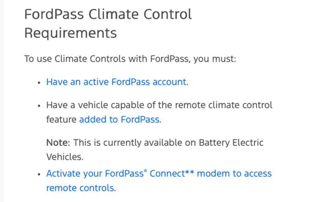

Reading this carefully and looking for why some do/some don't...
Ford F-150 FordPass app - Climate controls appeared then disappeared 1756498177066-d4
I suspect my not having access to climate controls on a remote start is due to not having Fordpass connect (Premium Connectivity).
Does anyone have Climate Control and not have the premium connectivity ($10/month)? And does anyone not have Climate control but believe they meet all three above requirements?
