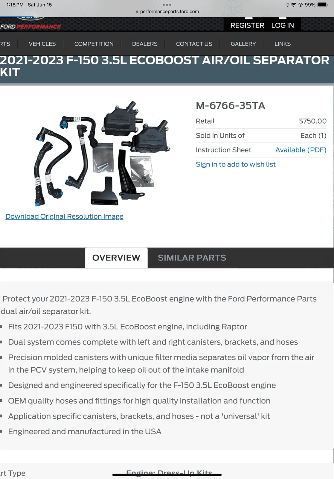

Has anyone tried this package on their powerboost? I would think it would work just maybe where everything mounts
Well it should be standard on tye turbo engines

Looks like once in a while both separators have to be removed to empty them out by disconnecting he hoses and removing the separators! The left unit is also not that easy to get to. Why couldn't they just design a separator similar to J&L where you can unscrew the container part?
I think this $750 is a waste of money. I myself spent a little less than this (about $500) and got a UPR Catch Can passenger side, driver side (clean side) separator, a Billet Pro Series Check Valve added to my Continental hoses and a Billet One-Way Crankcase Breather. Saved me over $250 and yes there’s plenty of videos showing that even Fords version of the catch can requires self maintenance which seems way more difficult than a traditional catch can like UPR or JLT. My opinion is that every engine needs a catch can because every engine creates blow by gasses and pressure in which produces engine sludge. I have this whole setup from UPR including a Billet One-Way Crankcase Breather so that my engine can breathe a little bit better.
