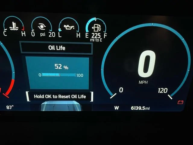

The last time I was at my dealer (warranty work...grrrr), I asked the dealer to change the oil. The dealer said "oh, it's not time yet. Your truck will alert you when it needs fresh oil". I'm sitting just over 6K miles and I'm not anywhere near the first oil change alert. That seems a little bit obscene, even with modern technology, that my truck wants to go 10K miles before an oil refresh.

I feel that using full synthetic and just changing it when your truck says is your best bet. I have over 280,000 miles on a 2010 5.4 V8 and have performed oil changes in this manner, and the cam phasers and engine are all original with no issues
Ford wouldn’t put an oil life calculator that recommended oils changes at 7500-10,000 miles if it was going to damage their warrantied engines.
If people would research oil types and tests for those oils, they would find that paying a few extra bucks for the oil product Actually means it is a better oil vs the competition.
Most importantly, you want to make sure the oil meets or exceeds the new oil standard (GF-6 or GF-6A).
Conventional oil uses viscosity enhancers to make the oil a certain thickness, which breaks down over time, causing the oil to change viscosity as it ages.
Synthetic Oil is engineered at the molecular level to be the stated viscosity with little or no viscosity enhancers to break down. Meaning that synthetic oil is marked as 5w-30 will remain 5w-30 for the entire oil life. The oil filter will clean debris until it goes into bypass. If the oil filter isn’t bypassing the old synthetic oil, then there is no reason to change it early because age does not break synthetic oil down
This is why German cars which require full synthetic oil changes go 10,000 miles between changes, safely, and under warranty.
Full Synthetic Oil will make you engine last longer, regardless of how often you change your conventional oil blend.
