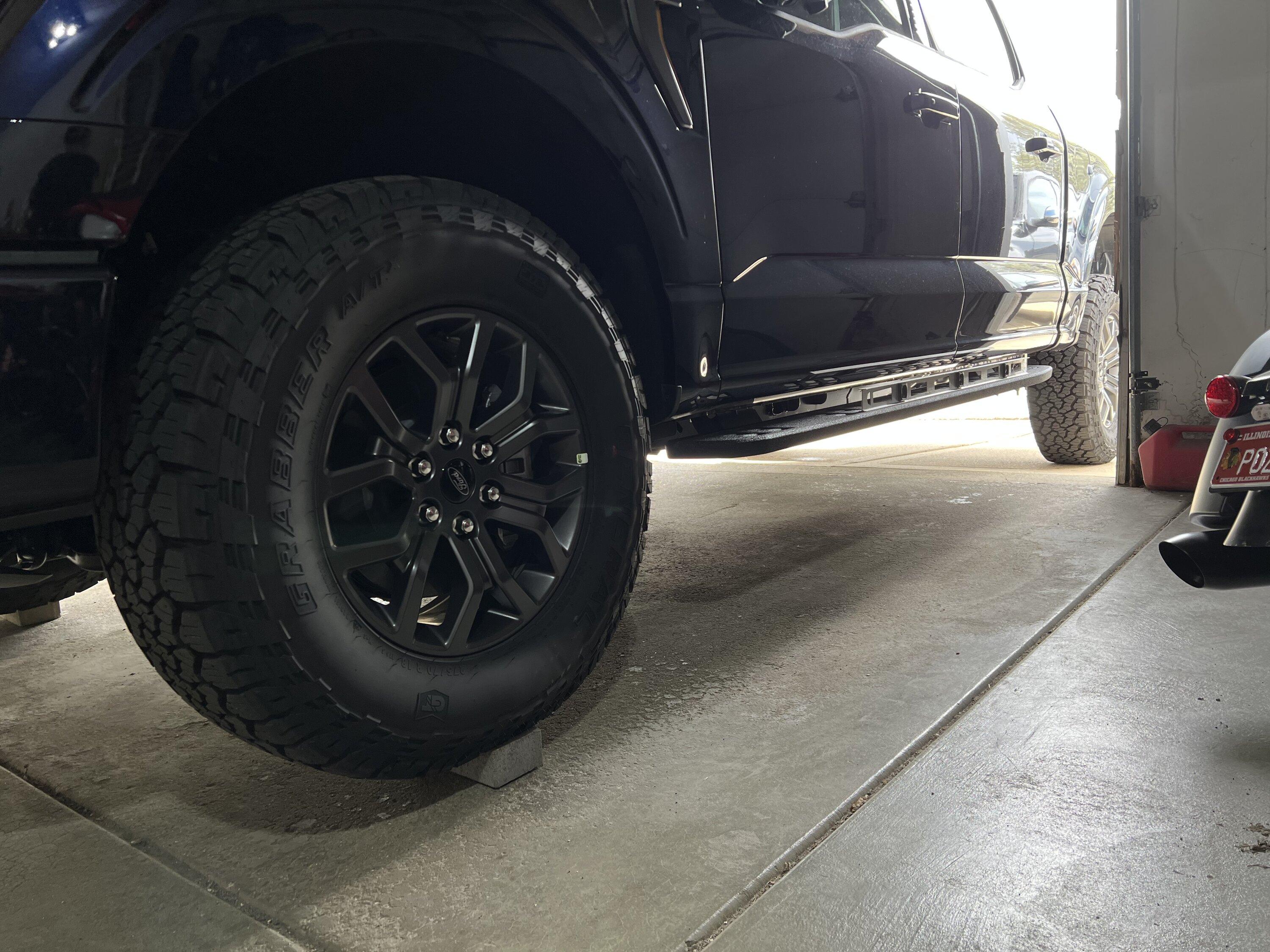

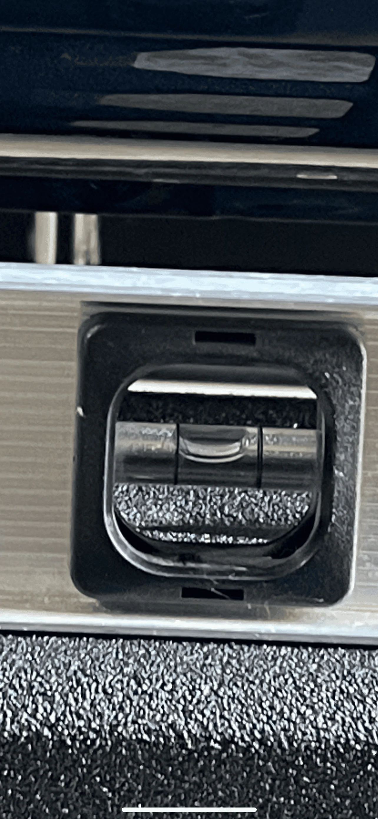

Welp…..thanks for all the info and words of encouragement. The deed is done.
Based on the feedback that it might help to have the truck more level to facilitate everything draining, I decided to get a little creative.
I put a level on the running board since I assumed that it is hopefully parallel with the frame.
Here’s the results on flat ground in my garage….
Ford F-150 First Oil Change - V8 Tremor 183FE580-26FD-4235-A179-6994772A19AB

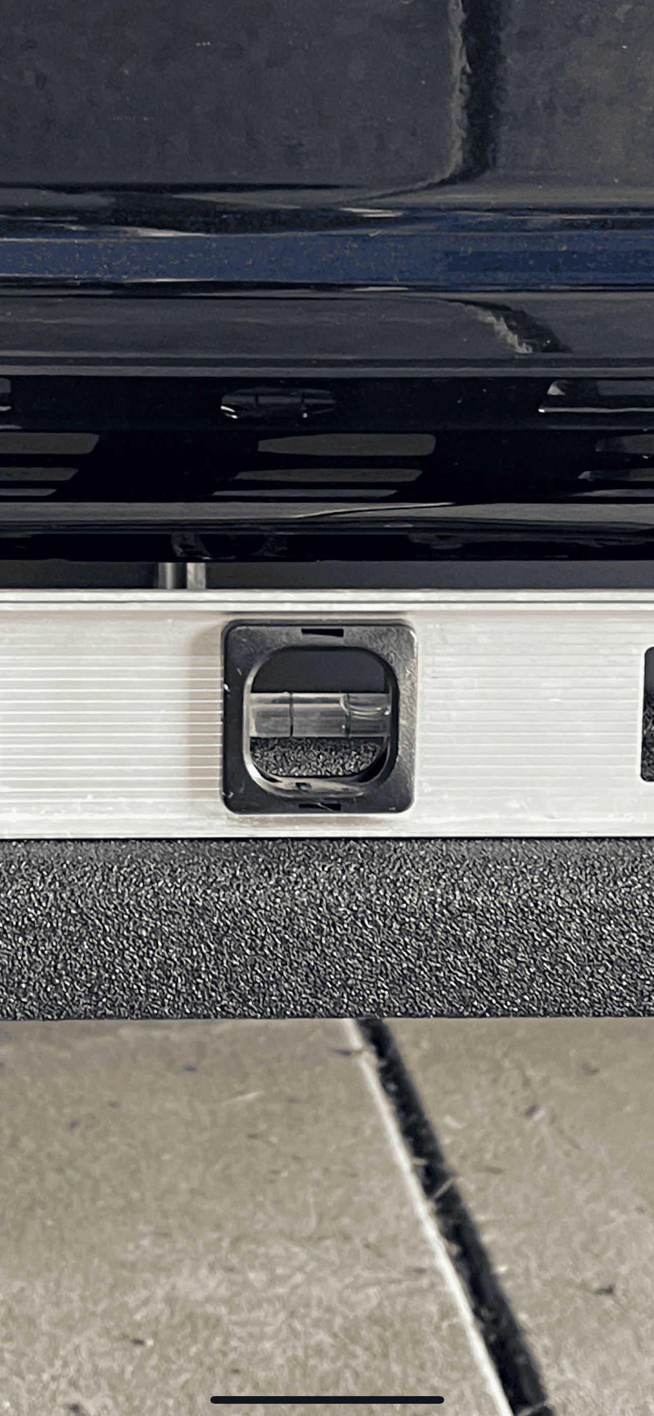

Then I put the front wheels of the truck on the flat garage floor and kept the real wheels on the slanted driveway which yielded the following…..
Ford F-150 First Oil Change - V8 Tremor C77428BB-6AEE-442C-B77B-10AC6C45B7F5
Finally, to give it a little more angle and even provide a bit more room for me to get under the truck I pulled the front wheels onto two bricks…..
Ford F-150 First Oil Change - V8 Tremor 5B5D7E16-BA01-4522-8C86-207AE0BF8F0F
