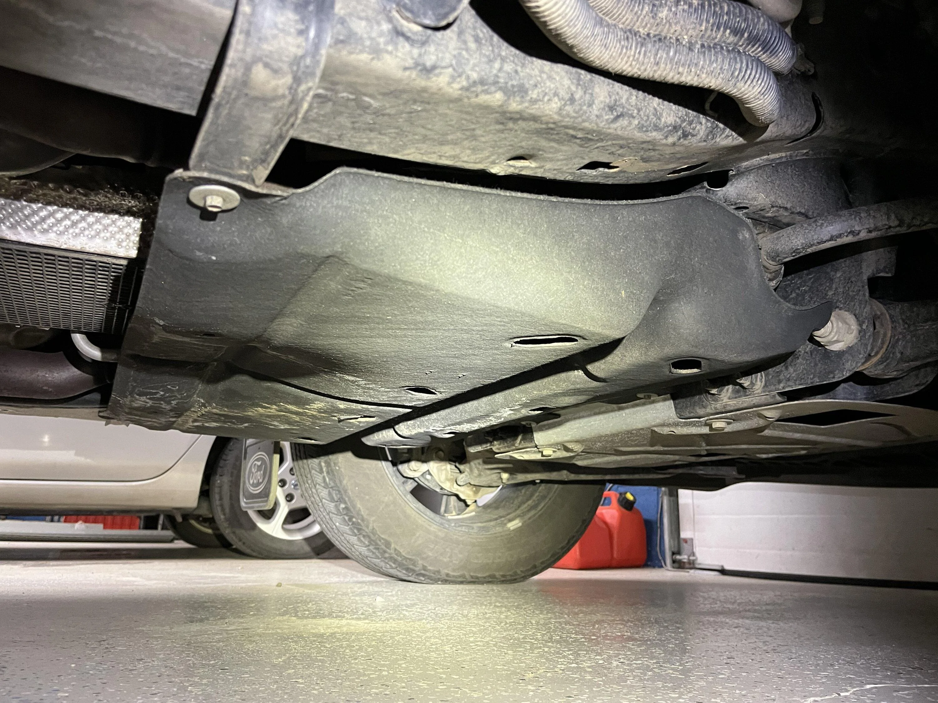

Well, I will post back either way when it shows up. That was by far the cheapest option with shipping or pickup included. I looked under my XL tonight and I do have the fabric diaper so I didn't order any bolts or nuts with it. I pushed on my fabric skid and it was rattling around. So now I know why at startup I got a rattle. Looking forward to ditching the rattling diaper and installing this metal skid plate. Our local mountain bike parking area is notorious for catalytic converter theft. This will give me some piece of mind they might pass on mine due to access.

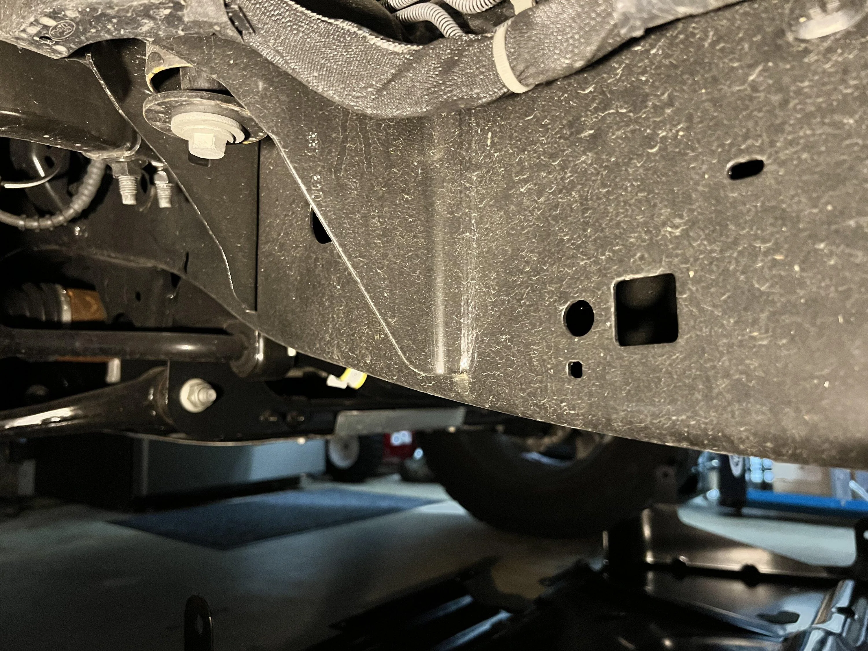

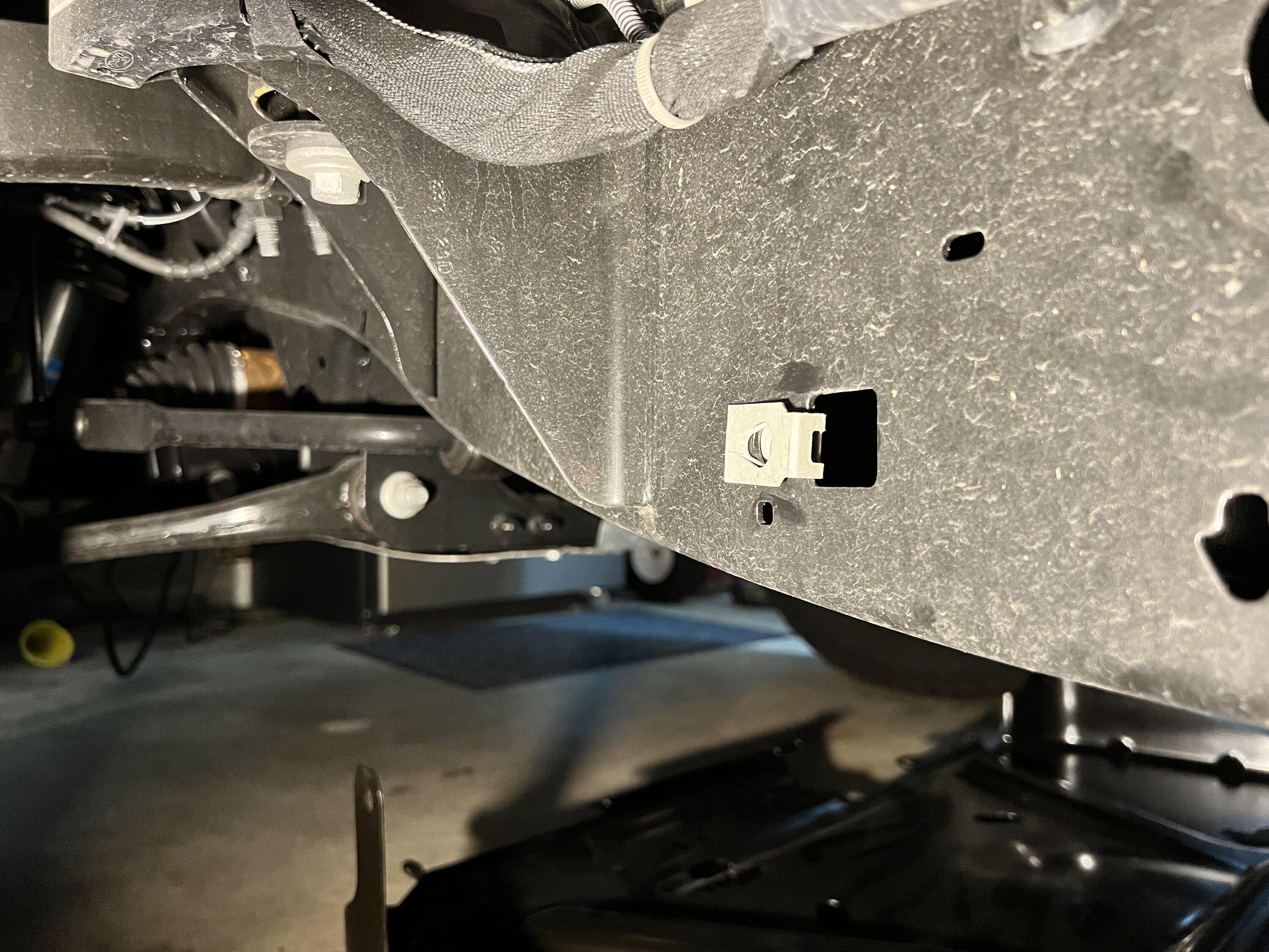

My fiber plate and all mounting hardware are intact. I am going to try and resell those parts and hardware. So I will need all new for the metal skid plate. 7/16 SAE is about 10% bigger than M10 and more readily available at the hardware store. I am going to buy 7/16 clip buts and 7/16 security head screws to provide another deterrent for cat thieves. The frame cutouts for clip nuts and screws are big enough.​

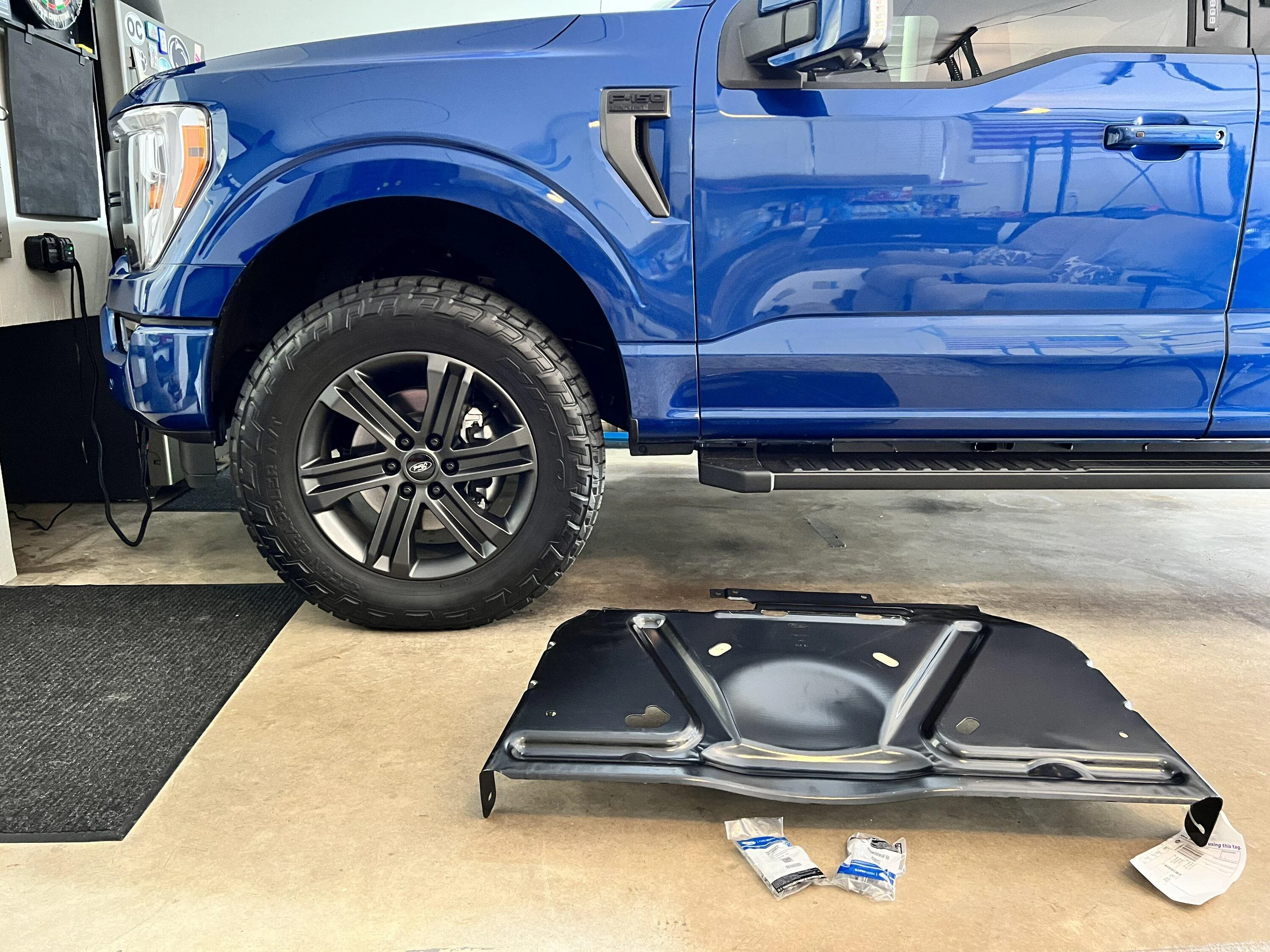

Ford F-150 Factory catalytic converter protection PXL_20230503_160653654
Dang, Ford overnighted my skid plate. That's good free shipping!
Been searching for a 7/16-14 tamper proof security fastener and no luck. 3/8 is largest available. And that price is similar to M10 so I think I will stick with OEM size of M10x1.5. Hoping to get in installed over the weekend.

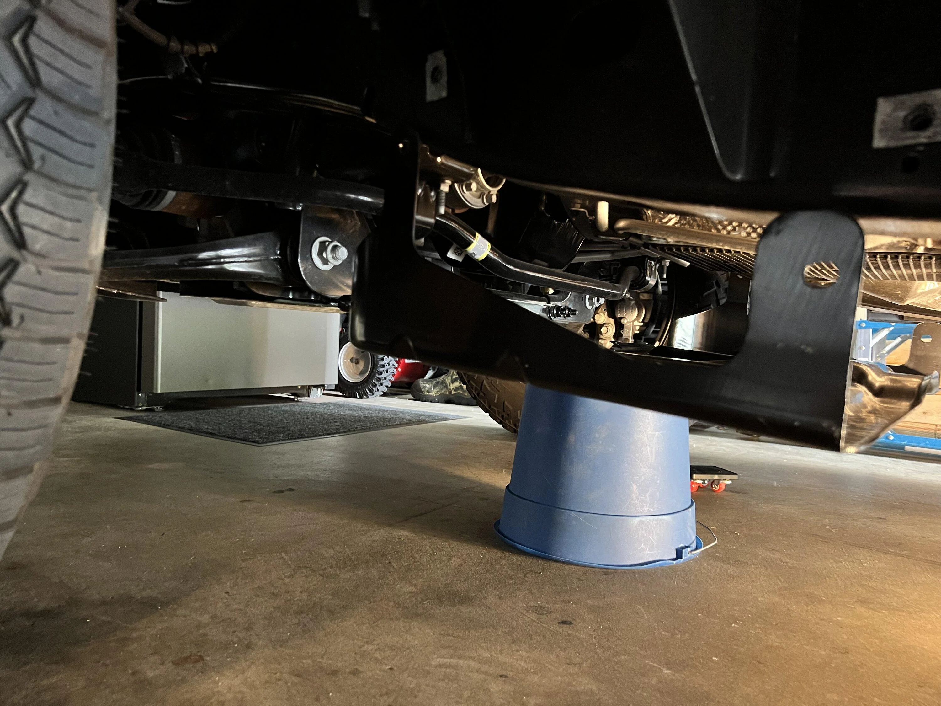

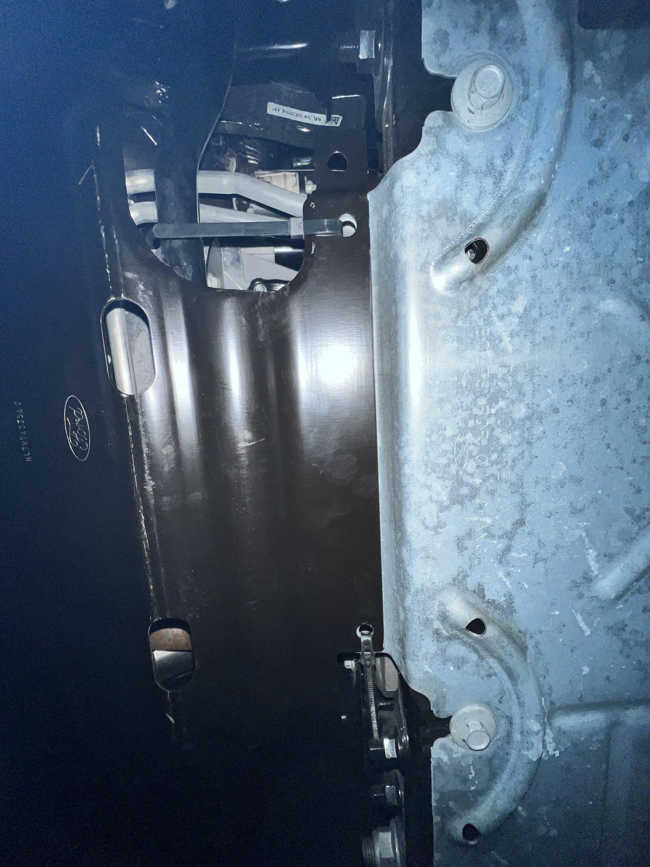

Installed mine yesterday but since I didn't have the OEM fabric cover, I didn't have the 2 existing bolts to reuse but everything else went smoothly. For now I used zip ties to fasten the protector to the existing skid plate to eliminate any rattling but can anyone give me the size bolts I need? I tried using the bolts I used to mount the protector to the side of the frame but they were too small. Not sure if I only need 2 bolts or also u-nuts similar to what was attached to the 4 mounting locations on the frame.
