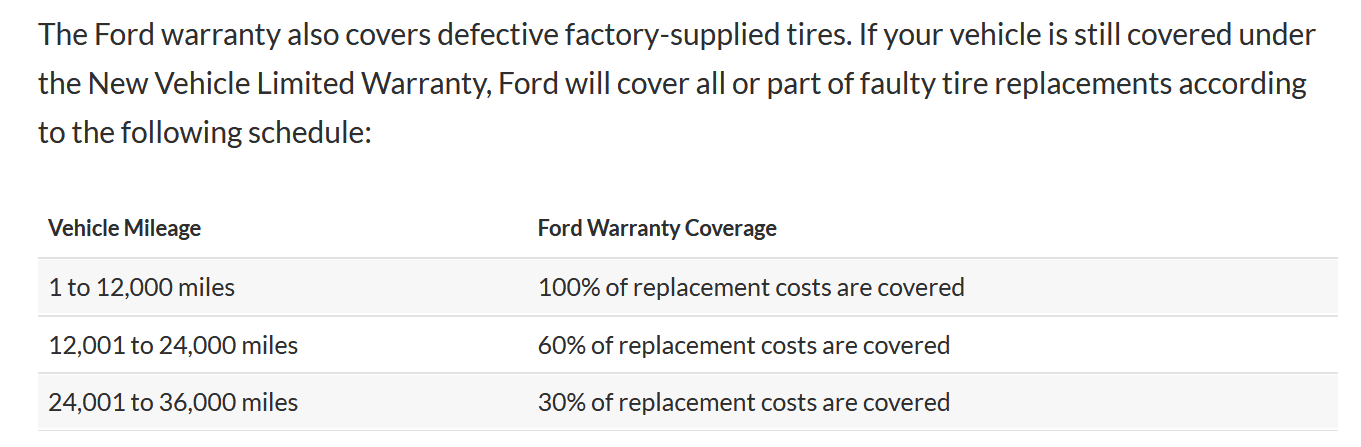

My 2021 PB had 22K miles and they were down to 3/32 and had to be replaced. I got a $429 credit under the warranty. 15K of those miles were towing to Alaska with some of their bad roads.
Who agreed to prorate the tire and give you the credit ?

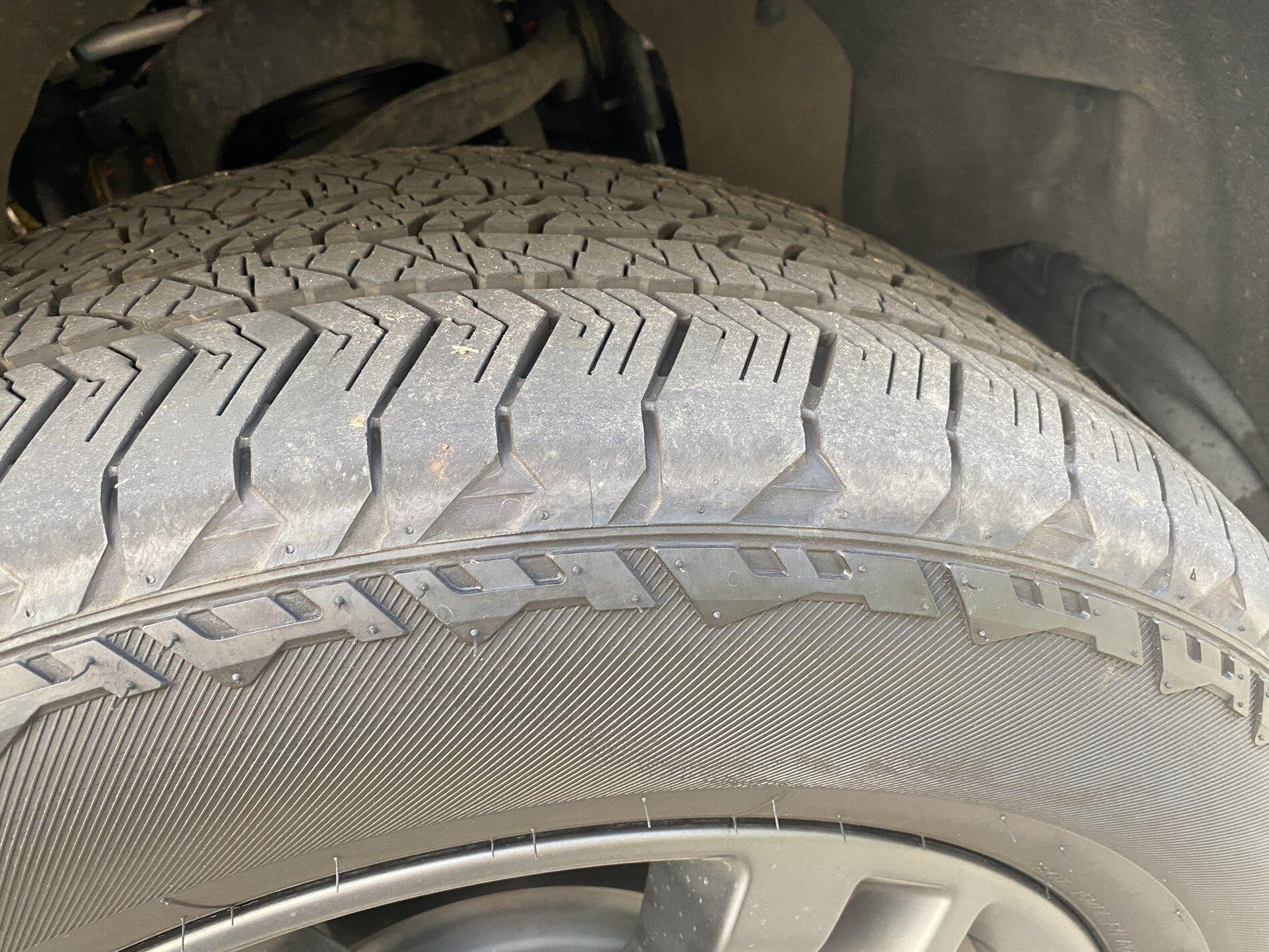

Got a picture of the tread. It would help understand. If the tread in the middle of the tire is not wearing, and the outsides both are, thats typically under inflation issues. If only 1 outside edge, then it would point to a camber issue.
I had the same problem. Provide copies of this thread as evidence to a Ford dealer. The tires I had on my 2021 were discontinued so I received a pro rated warranty claim. No one is claiming fault, however, after many tire alignments etc. I found a dealer that was willing to work with me and provide the evidence to Ford’s warranty claim department that these tires were defective. In my opinion, you have a case and need to have them replaced as soon as possible.

This thread makes me feel better about needing to replace my 20” Pirelli Scorpions after 28k miles, but I still don’t feel great about it. Same outside wear as everyone else is describing.

Ford trucks have always had an issue with the outer tire edge wearing faster. This goes back to the twin i-beam suspension era. It was an absolute pain in the ass to get dialed in, but once you did it was damned near impossible to knock it out of alignment. I always put a new car/truck in for an alignment around the 1K mile mark. Then take it back annually. Almost every time the first alignment factory settings are technically in spec but only just with the camber usually being fairly close to being out of range with either too much negative front camber. Rotating/balancing every 3-5K miles and keeping the air pressure set usually helps a lot too. Even then factory tires never get the mileage out of them you think they should before wearing out and needing replacement.
