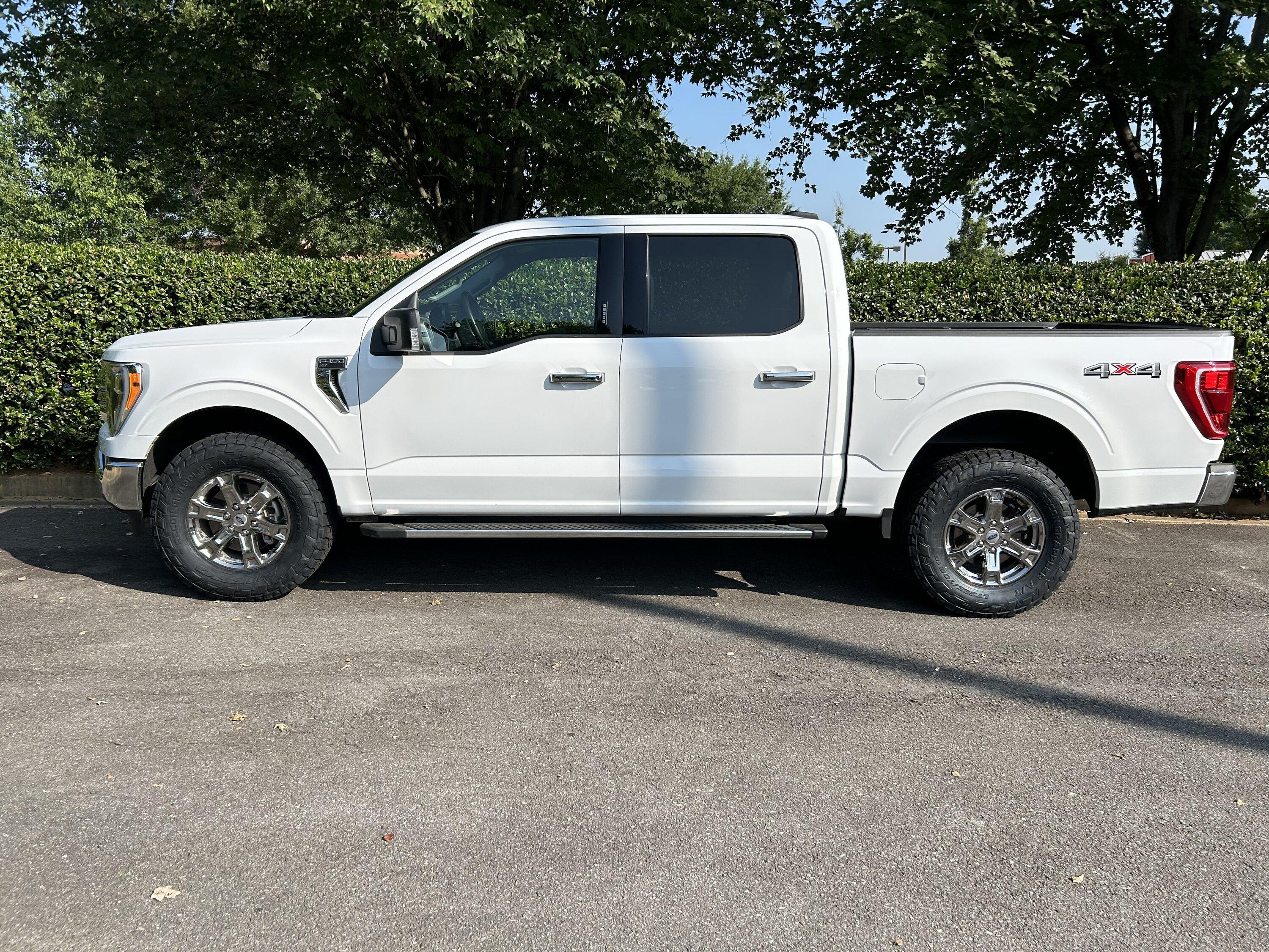

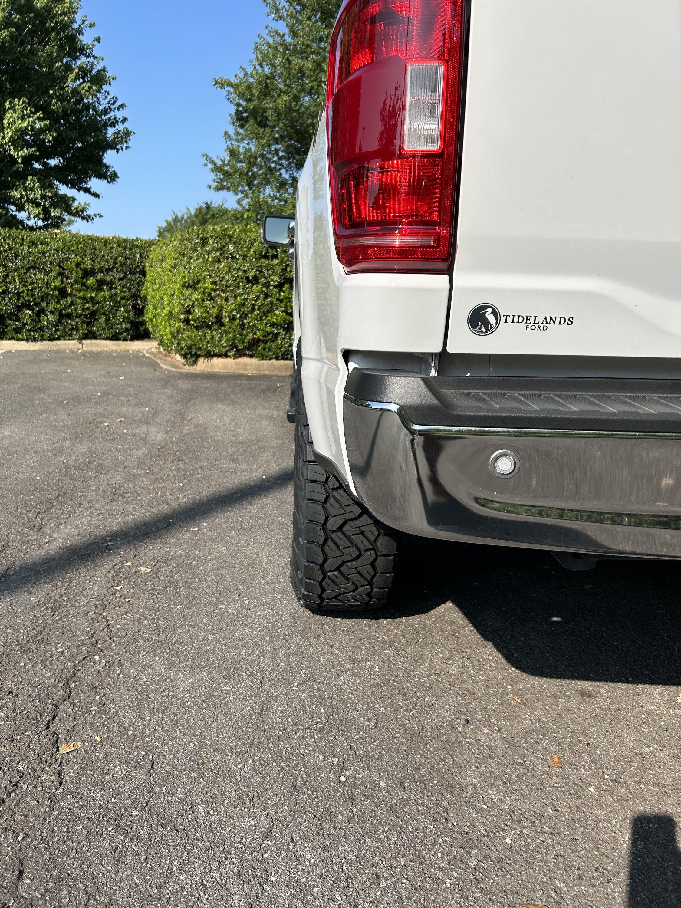

‘22 4X4 XLT before and after. Went from stock 275/65/18 Michelin Primacy to 285/70/18 Nitto Recon Grappler on factory wheels with no lift/level yet. No rubbing. I lost about 2 mpg. Nice ride, low noise.

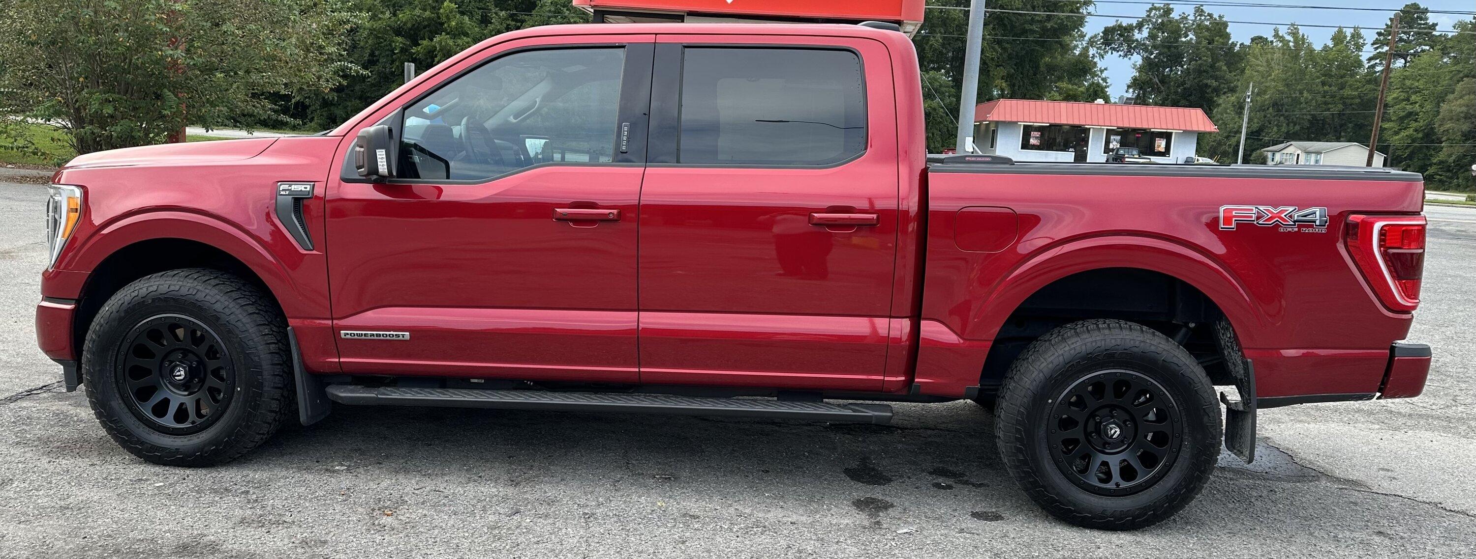

My guys @Discount Tire (NCC 35) Joe, Braxton, and Cash hooked me up again. Clean and simple. 285/65R18 Falken Wildpeak AT3W's and Fuel Vector 18x9 +20. No rubs, no trim. Just waiting on my Ford Performance level from @Stage3Motorsports

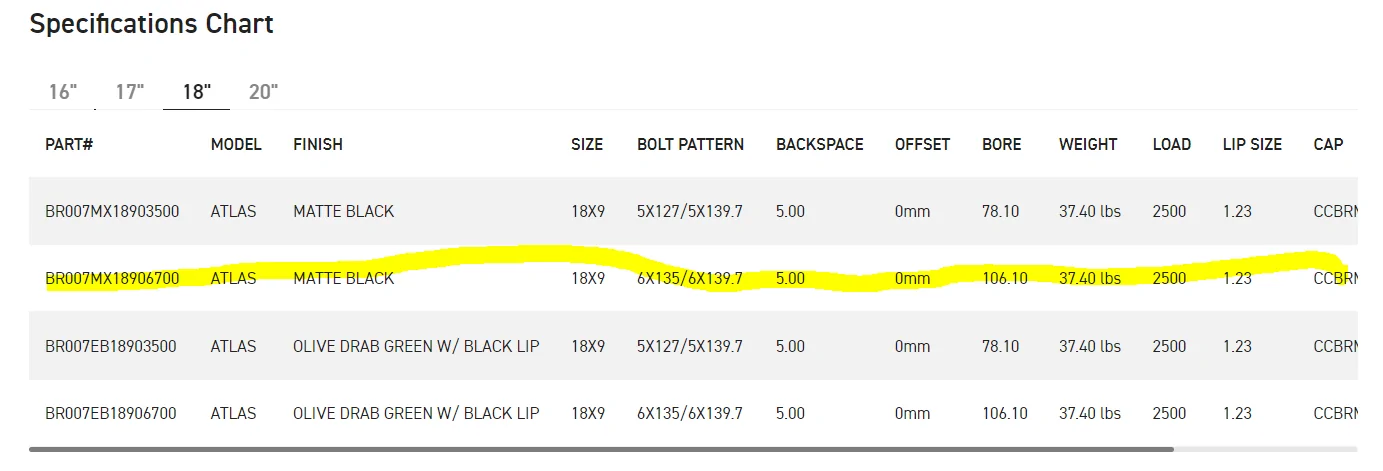

You have a level kit? If so, what kind and thickness? What offset of wheels. Thanks in advance?

I do not have a leveling kit. The wheels are Black Rhino Atlas 18X9, tires are BF Goodrich K02 (275,70,R18)
