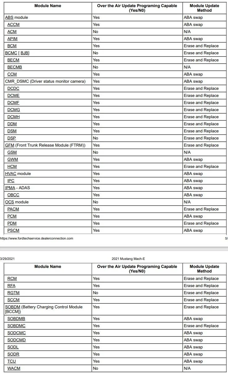

I’m not sure this update will ever go out OTA. According to @Livnitup ’s spreadsheet, the DSP cannot be updated this way.
You are correct.
Now you guys know. If you want the update, it has to be done through the dealer or with a Mongoose tool if you have one. Unfortunately, the only way to see if it does fix it, is to get the update and then wait and hope it never happens again. ?‍♂
