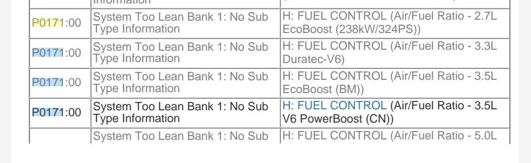

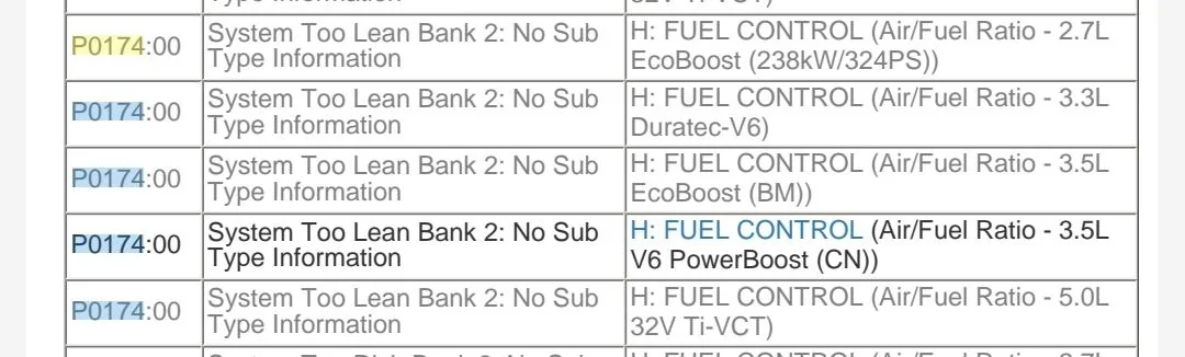

Let me go fetch code info for you

I reset the error. Running good now. One thing I don't like is the codes moved into something called permanent listing. Can't clear that. I would hate to store every code. With all these systems things could go bad and I woukd think a buyer would get spooked.
