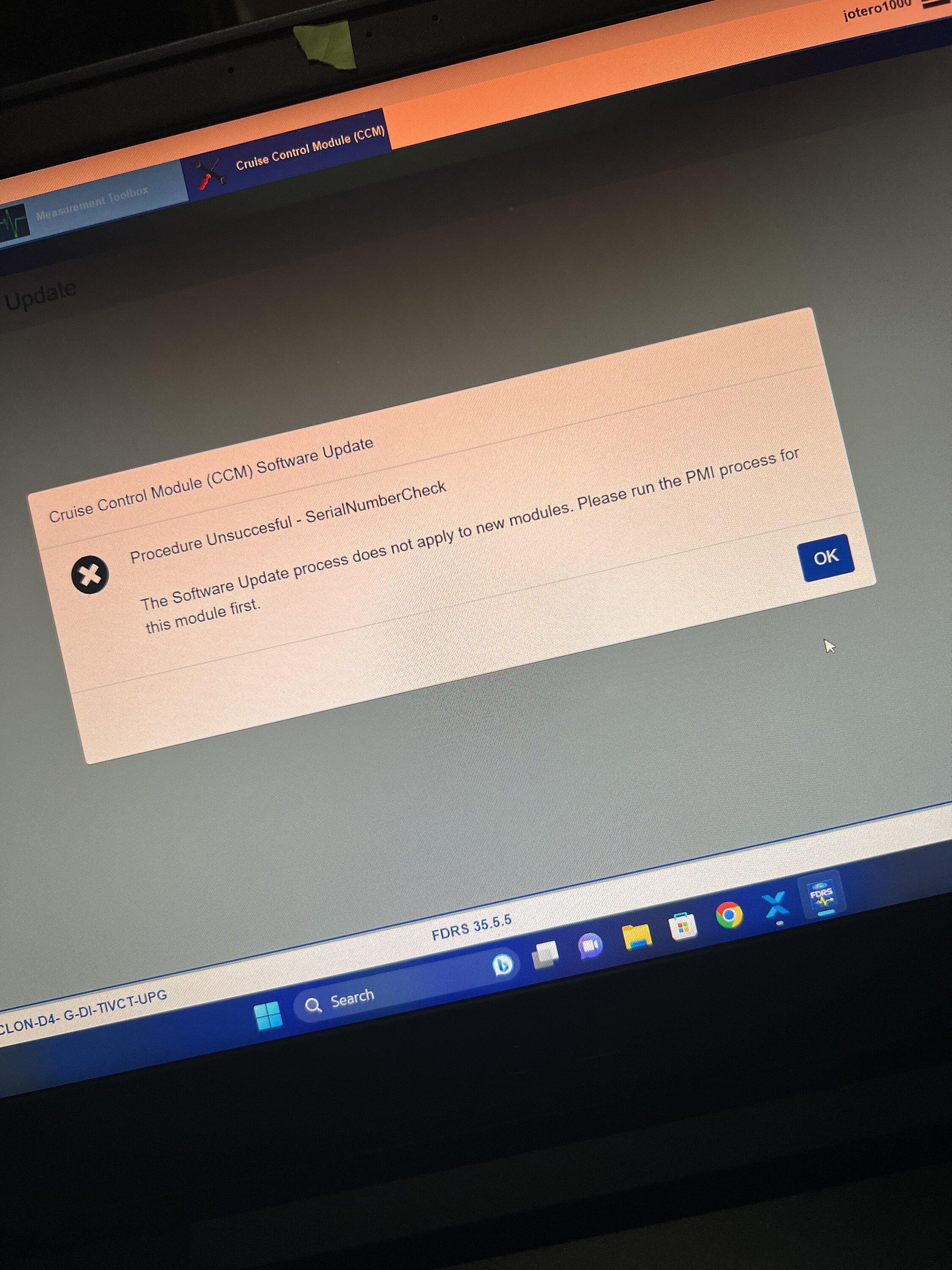

tried to update my CCM and it failed for some odd reason. Now I have a pre collision assist not available and I can’t finish the update it gives me this issue, I tried running PMI like it says but it detects the same cruise control part. Not sure what to do…
What cable are you using to update

lol I guess thats not the proper one, thankfully I did order the Mongoose one as well, it just came in this afternoon, would using that one work better ? What should I run to fix my issue ?
YEs.

Thank you guys, I guess the nano sucks. Mongoose fixed the issue. I really thought I was going to have to take it in
Just out of curiosity, Why did you start with the Nano?
