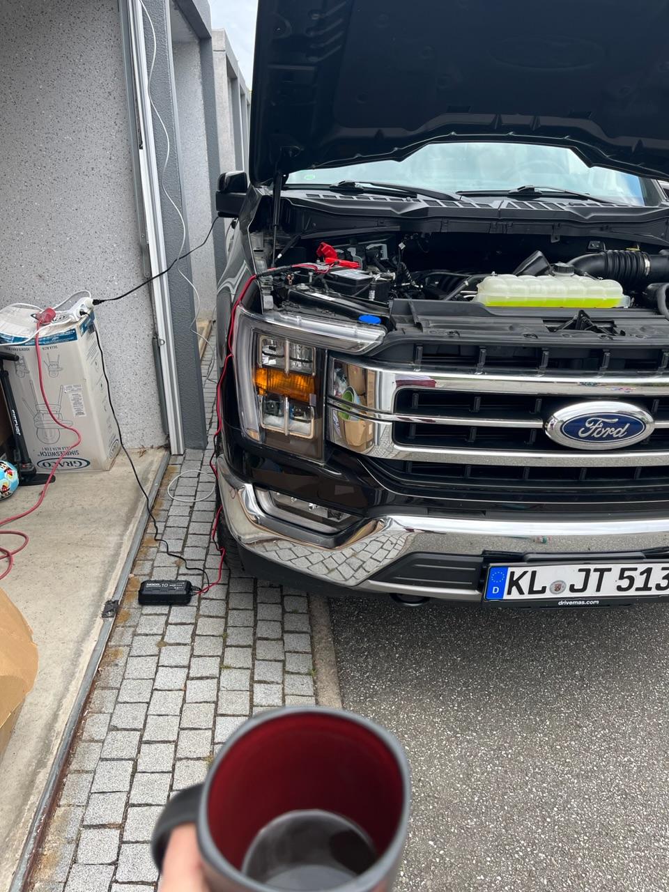

Why is FDRS so slow to write to USB? Taking over an hour to transfer 5GB updates. The USB is rated at 11.8MB/s write, but with FDRS it caps out at 1.8MB/s (not sustainable). I've used the USB from this very computer and it was much faster.
coffee break
Ford F-150 ECU module programming guide using FDRS IMG_8211
FDRS definitely throttles writing USB sticks.
It's time to listen to a Playlist, sip a beverage, and catch up on the forum while it does it's thing.

May I ask what battery charger/tender you are using?

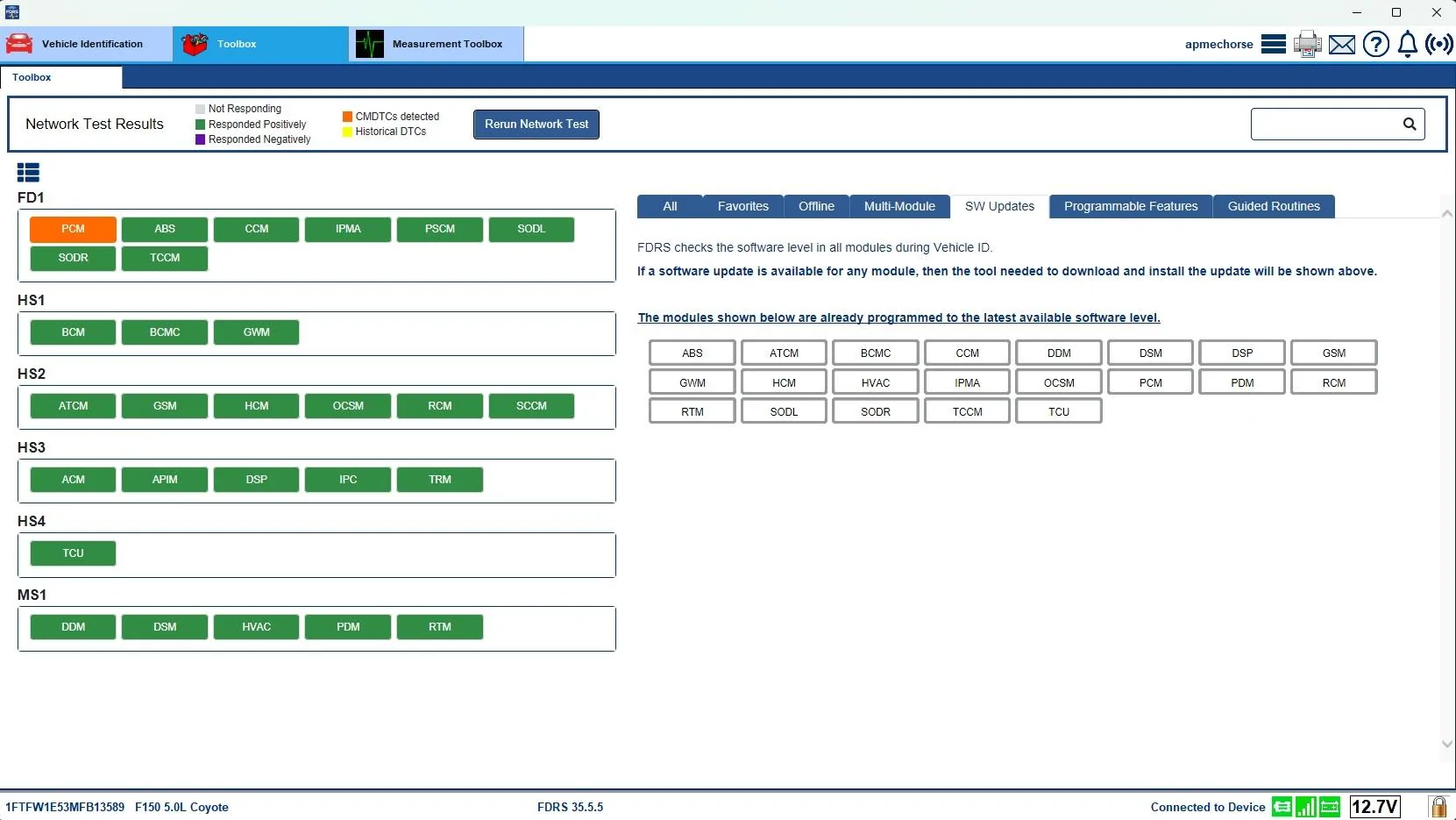

OK, so this means I'm finally all caught up now, right? I should be at PU 4.3.2?
Ford F-150 ECU module programming guide using FDRS FDRS
(Disregard the DTC for PCM, its a U0645 - Lost Communication With Active Air Dam Module. Snow drift broke it last winter then I just removed it entirely.)
Is there anything else I should be doing while I still have time on my license?

I'm very happy to see that you were finally able to get your truck fully updated. It's an amazing day we live in that the members of the forum here were able provide you the information and guidance to do this, But ultimately through your own determination you made it happen, Great work! Hopefully you and that F-150 will be back rolling on the U.S. Interstates soon.
With Memorial day coming up, Let's take a moment to remember our fallen heroes, and I'd like thank you personally for your service to our great Country.
Thank you, Sir!
