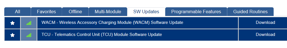

Wasn't expecting this:
Job2 2022 and accidentally launched FDRS instead of Forscan. Decided to go ahead and do a scan but wasn't expecting anything since nothing has been mentioned.
I'm not ignoring a TCU update, so went ahead and downloaded it.
It's USB based and I think was about 148Megs?
Stuck it in the truck following the same old FDRS instructions that we have all grown accustomed to.
But after it indexed and "Applying the update", the Sync screen popped up with :
Ford F-150 ECU module programming guide using FDRS 20221001_170222
Don't know if I've ever seen Ford officially recommend a time interval or the open door suggestion?
You think the software developers are following the forums success and suggestions?

Huh, wonder if the other update actually does something to fix current function to overheat your phone without actually charging it?
Don't know. I did just apply the WACM update, but I got weaned off of even using it after experiencing its shortcomings.
If it's any better, I'll be sure to mention it
it’s new to 22228
wacm is the wireless charger it’s fine
